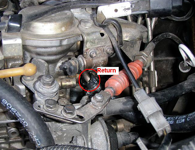

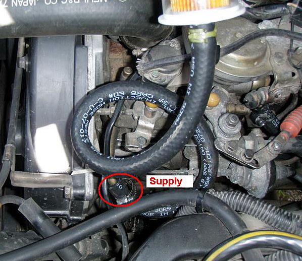

The explanation I found on delicaclub.ru was quite simple.
Disconnect both (input and reverse) pipes from a fuel pump, connect short pipes (50-60 cm) instead and put them into a bottle with cleaner (he used Wynn's). Start the warm engine, idle for 10 min. Shut the engine, floor the pedal and start the engine. Run the engine at 1200-1500 rpm increasing and dropping rpms sharply until it burns the first 0.5 l of cleaner. Shut the engine and wait for 10 minutes. Start the engine and burn the second 0.5 l of cleaner at 2000 rpm pushing the accelerator once in a while. Put some diesel in a bottle and run the engine again to burn cleaner left in the system. Restore fuel connections.

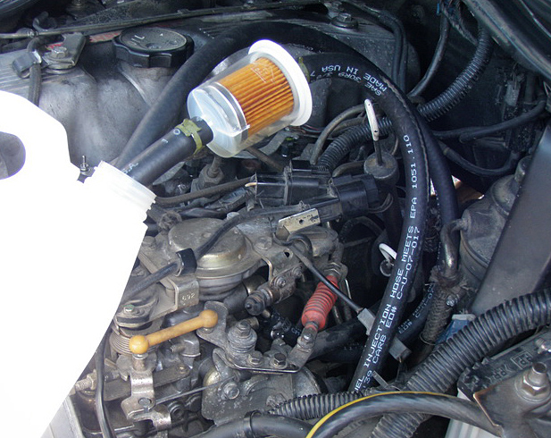

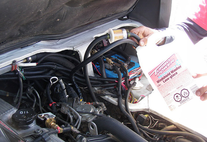

You asked for it and here it is. The drill was explained earlier and below are some illustrations. Good luck!
