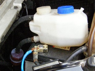

This is how it may look if you DIY:
Here is a Wynn's commercial: http://video.aol.com/video-detail/wynns ... 1897901430 but they make it too complicated (and expensive I guess).

here is how somebody does it on a mercedes:
http://www.dieselgiant.com/injectorcleaning.htm
scroll down that page to see a diesel purge on a mercedes..

Re: Diesel system purge
Wow After oil that is sweet!
How much did that reservoir cost,it looks like space age carbon fiber-lexan hybrid.
Plus custom molded hoses!
I am definitly going to have to get another job to keep up with with you!
Mad-money!
Seriously ,very nice
Right on!
Mad-money!
Right on!

aww thanks.. but that photo is actually not mine.Luna-Sea wrote:Wow After oil that is sweet!
Mad-money!
Right on!
