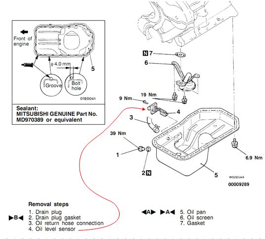

So I'm looking to install an oil temperature sensor like this one - in the sump. I'd like to avoid invasive and hacked modifications of the oil pan.
One approach is to use the oil level sensor hole, like this aftermarket solution for a completely different vehicle. Another I considered was putting something inline on the oil return hose.
Below is an image of the oil pan. I haven't been able to get a part number on the oil level sensor or a detailed illustration. Thoughts?

RichD wrote:So I'm looking to install an oil temperature sensor like this one - in the sump. I'd like to avoid invasive and hacked modifications of the oil pan.
You could tee off your oil pressure sender for your low oil warning light. It only requires a "splitter".
