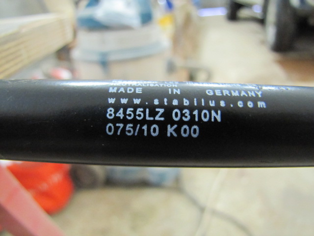

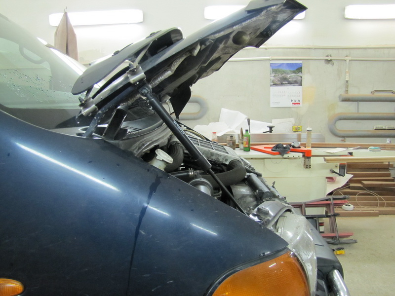

Here is the mod for lazy drivers :-D which allows them to open/close the hood with one hand. it was posted yesterday on delicaclub.ru.
The original post with pictures and the video.

Any idea if this is an L300 or an L400 strut?
Joe

This is a Volvo strut.

Couldn't get hold of a Volvo one; bought a Subaru one before seeing the part no. posting.
No go, too long. Will attempt to find Volvo one.
Joe
