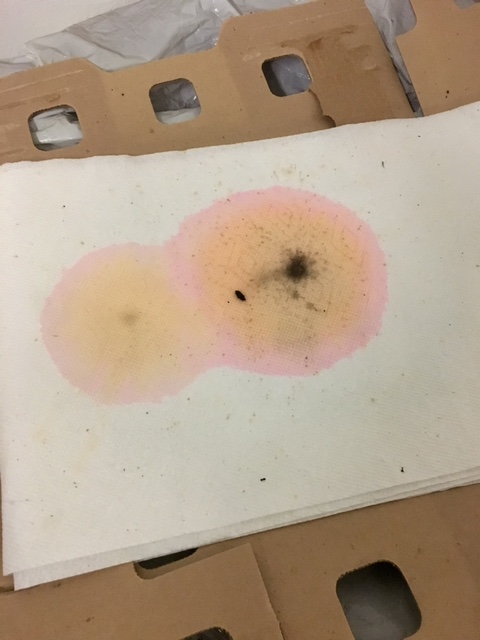

I came out to my van in the morning and discovered a significant coolant leak. Try to ignore the fact that the leak looks like boobs :-D
Oil level is fine. Transmission fluid is fine, brake fluid is fine. Coolant in radiator is good, but the coolant in the expansion tank is low.
I drove the van and it does not overheat and drives perfectly well. Park somewhere for half an hour or so and come out ... NO leak. Come home and park the van overnight and bam .... leak.
Any ideas?

I had the same issue. Mine turned out to be the head gasket.
Coolant LEAK but only when COLD!
Could you confirm a couple for things for us?
-Is the coolant in your radiator red? (not green)
-Where was the paper towel placed- under the front or the rear of the engine, or the passenger or drivers side?
cags005 wrote:
Coolant in radiator is good...
I notice the oil is concentric with the coolant, which suggests they're dripping from the same spot, which rules out the expansion tank (there's no oil near the expansion tank). There's not too many places where an oil and a coolant leak come out at the same place. I'd guess the paper towel was under the alternator (drivers side of engine) or rear of engine/bellhousing.
The "coolant" almost looks like transmission fluid from the way it's separated, and the way the oil looks like it's dissolved into it a bit.

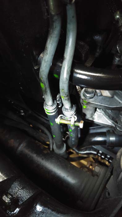

Since I just found this photo, here's what a coolant leak from the water pump area looks like:
This is taken from the rear of the engine, just below the exhaust pipe, looking forwards. The two pipes are transmission cooler lines.

Well I (with the help of a buddy) located the coolant leak problem and Growlerbearnz you were right ..... it's the water pump! Super happy to know what the problem is!
Awesome(ish). So much cheaper to fix than pulling the whole engine for a frost plug. Along with the water pump you'll want to change the thermostat, and the little O-ring on steel pipe at the back of the pump.
