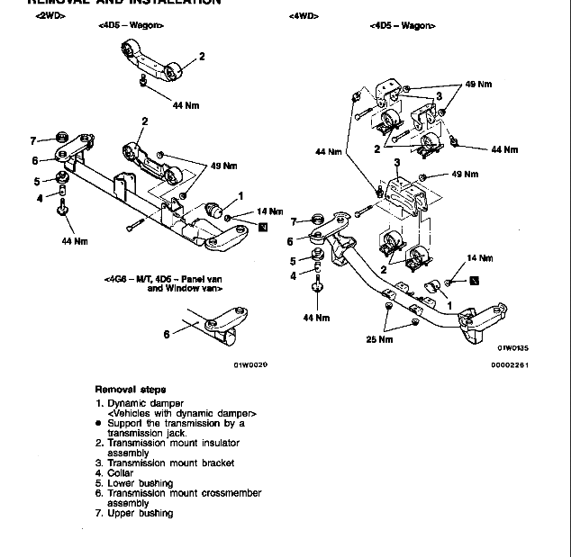

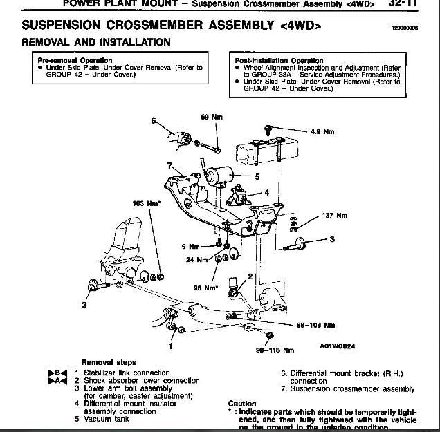

Anyone have part numbers for these mounts?
First pic: No.4 insulator
Second pic: No. 2 on the 4WD side. The 2 insulators

I just did mine, huge difference after. Let me know if you find these domestic!
L400 rear transmission mount - MG27M2168

Thanks. Are all three the same part number? Where did you get them?

There's only two, easy to replace with a bottle jack. I got them from Rocky Mountain Imports

They're just cracked and there's a fair amount of movement. I just got the Delica and would rather just replace them. Super simple to do I figured why not. Hope they're not to expensive.

I had a pretty hefty vibration when idling and taking off from a start. I could really feel it in the 4x4 shifter. U-joints seemed fine, so did pinion. Trans mounts however looked horrible. I was just looking at the front diff mounts though, they also need replacing, and are a much much more involved job I think.Firesong wrote:What were the symptoms your were experiencing to want you to change them?

They're expensive!WhoGotTheFunk wrote:They're just cracked and there's a fair amount of movement. I just got the Delica and would rather just replace them. Super simple to do I figured why not. Hope they're not to expensive.

If I remember correctly they're about $125 each. No aftermarket options available and L400 specific. Same with the rest of the motor mounts and bushings.Firesong wrote:How much is a mount worth?

That's crazy expensive. There must be something similar to these for another vehicle. I'll do some digging next week. I may even be able to make something. I mean there's really nothing special about the bracket they mount too.

Sorry, I didn't read your first post properly. I didn't even know there was a third one! Anyways, keep us posted!WhoGotTheFunk wrote:Thanks. Are all three the same part number? Where did you get them?
