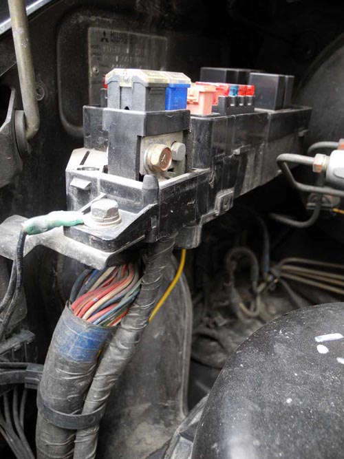

The DRL, if it's connected the a black wire with a thick blue stripe under the fuse box in the engine bay, disconnect it and I'll send you the instruction to wire it up correctly. Yours may be linked to a hot wire even with the ignition switch off.

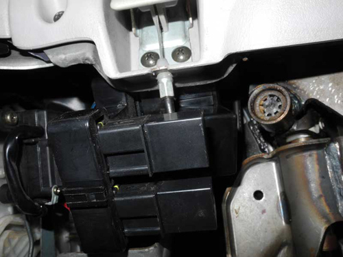

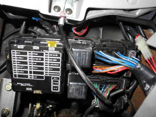

Here some pics that I took this morning maybe that will help to located the DRLjessef wrote:Claude
Thanks a bunch
Claude

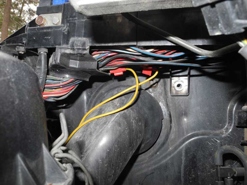

Re: Weird healight problem
looks like it's hard wired (yellow) wire.
trace the yellow wire from the headlights and let me know which contact wire it goes to under the fuse box.

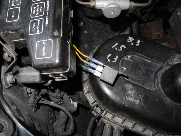

That is what i found following the Yellow wire. A relay I suppose, and the other wire go to the headlight .jessef wrote:looks like it's hard wired (yellow) wire.
Could it be that the relay is faulty.?
with Ignition off light is on and when I unplug a wire light comes off
