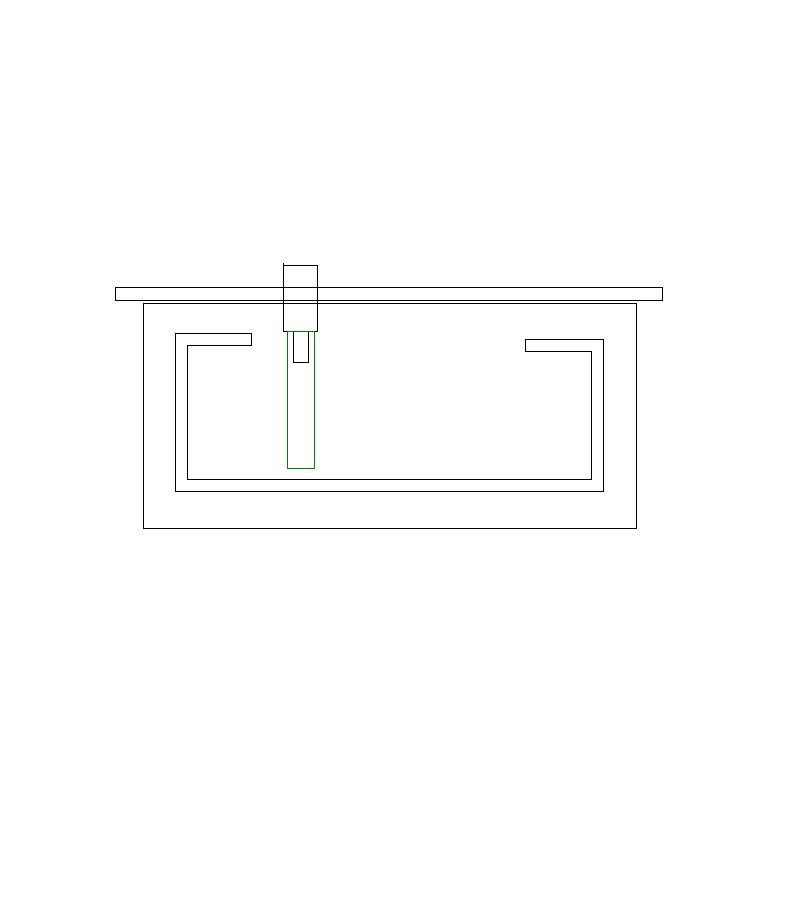

I have a RAW power centrifuge and I am happy with it, I did notice I was getting some splashing so I came
centrifuge fix.JPG (21.18 KiB) Viewed 12908 times
up with an easy fix after looking at their upgrade. Attached see a simple drawing of the RAW Power bowl, I added a small plastic tube onto the small nipple which delivers the oil. This forces the oil to the bottom of the bowl and in my mind greatly improves the efficiency of the centrifuge without the expensive upgrade.

dfnder wrote:I have a RAW power centrifuge and I am happy with it, I did notice I was getting some splashing so I came
8-) 8-) 8-) 8-) 8-)
