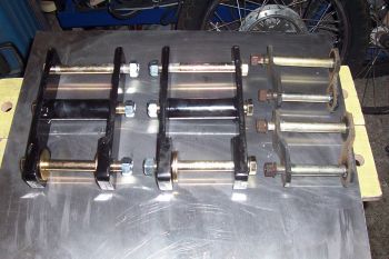

this is a picture of the longer shackles next to the stockers, on the right.much stronger and uses a tie bar in the middle to keep everything from twisting.

Many of us would like to know what you'd charge for a set of shackles and upper ball joint spacers, for the DIY crowd?garyo wrote:this is a picture of the longer shackles next to the stockers, on the right.much stronger and uses a tie bar in the middle to keep everything from twisting.

Me three!Many of us would like to know what you'd charge for a set of shackles and upper ball joint spacers, for the DIY crowd?
I like the stance and the fact the torsion bars don't require maxing. Does this affect the driveshaft lengths at all or does the lift sort of pivot around that? And... would you consider going higher like the Mystery Machine?

The complete kit stands your truck up right. Come down to the shop. 2 lift kits available. Kits costs $400. Install another $600. Bring cash.

also comes with new lower rear shock mounts.i've been running this setup for 3 months now,no problems. this means u dont need longer shocks.this can be an upgrade later.factor this in, and the whole system is very reasonably priced. also, in the process of building a bigger lift ,spacing the front subframe a bit. a work in progress. we are getting a lot of positive feedback, so we'll probably have to build some more.

ya dude im in. 400 bucks i want one at the end of the month 4" front 3" in rear or 2" . do i need new leaf springs maybe add a leaf and shocks can be done after great. I need new wheels and tires

Saw garyo's van @ North Van Red Robin parking lot. Sweet! Nice lift, and I should consider that as well.

Oh, that does look good!! What is the height at the top of the wheel wells?

I saw VSM's Delica couple days ago with that lift installed. I'd guess a good 6-7" between tire and wheel arch. Nice set up as it doesn't "stretch" the shocks and keeps the geometry the way it should be. I really liked it.

I have 30" BFGs & 32 1/2" height at the top of my wheel wells. Thats only 4 1/2" tire clearance with my torsion bars cranked to an inch of their maximum. They were cranked in Japan before i bought the deli. There's no lift in the rear.
I want a 2" more ground clearance. I suspect the TBs have sagged.
My questions are:
Can you buy new torsion bars? How much are they? Would there be any advantage to replacing the torsion bars rather than installing a lift kit?

37'' wheelwell to ground w/ completly bald 31's
