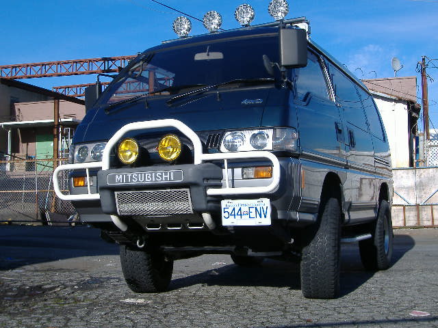

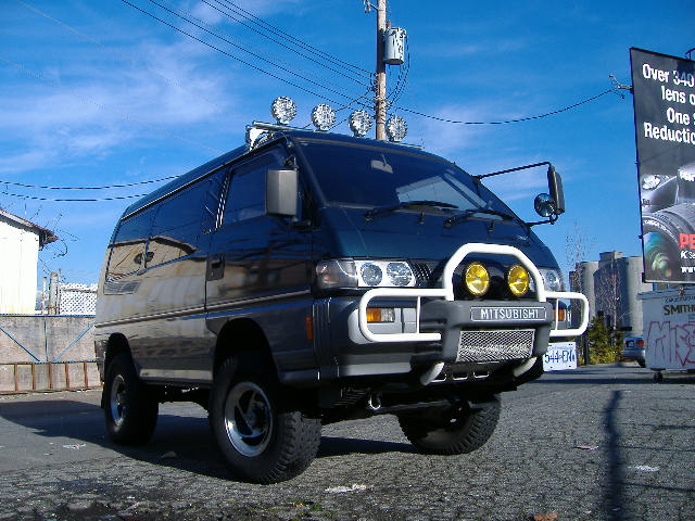

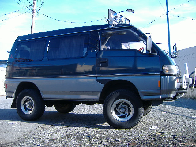

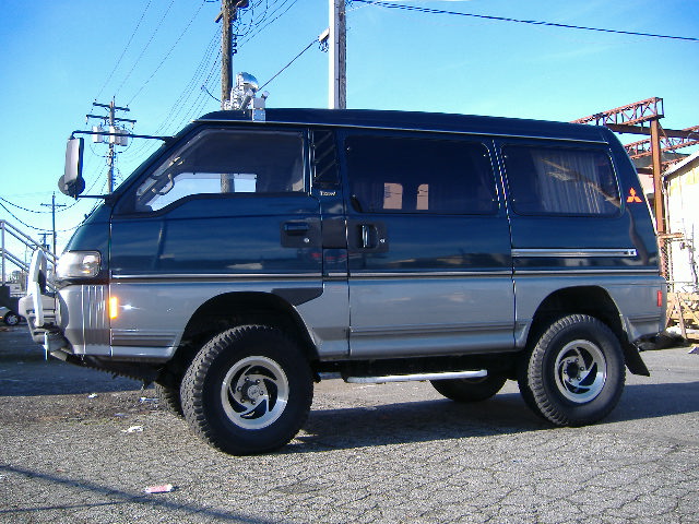

hello,new delica owner here. I have built and installed 2 lift kits already. mine has 31' tires with alot of clearence,no rubbing,no diving . 2' rear and 3' to 4' front lift.put on the 31's , I can slide underneath, on a creeper easily. slightly nose high looks very aggresive.back is raised w/ shackles, 4' over stock length, 2' in lift gained.my new shocks are not in yet,so Ibuilt shock extensions for the stockers ( could be a lo cost alternative to expensive new shocks).On the front have new pro-comps. made ball joint spacers, re-indexed torsion bars and adjusted, and modified bump stops. (still had to modify seam in inner fender well and remove steps).the nose is no longer so low,making me feel better about the skyline intercooler that is going up there.if there is enough interest i might be convinced to build more lifts.just came in from the shed, having milled 2 sets of balljoint spacers tonight. creers.DELICAS RULE.

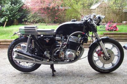

I have not thought about pricing. just tossing some ideas around.most of my time is taken up building old bikes.if anyone is serious about raising a van, best to talk to me (gary) in person. come see my van, maybe take it for a spin. come down to vancouver supermoto on powel st. and talk to mark or me.I would be open to trading for interesting old bikes,parts, cb750 stuff, like in this pic of one of my bikes
- php4xJfRUPM.jpg (80.52 KiB) Viewed 12384 times
Re: looking for lift kit
Thats one Crazy Cb 750 you got there GaryO. Many thanks for the ass kicking lift kit in my Van. Now if any of you are seroius about a better riding, better standing Delica come and check ours out any day of the week at 858 Powell Street (in the starbucks building).

finally got around to finding some pictures of the van.when i find the camera, i will take some more.
- Dscf2392.jpg (88.42 KiB) Viewed 12167 times
- Dscf2391.jpg (114.37 KiB) Viewed 12228 times
- Dscf2390.jpg (78.63 KiB) Viewed 12169 times
- Dscf2389.jpg (113.43 KiB) Viewed 13162 times
