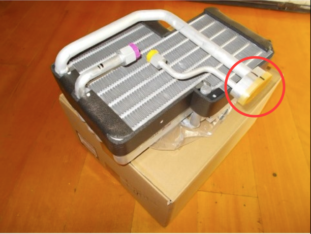

I removed my rear evaporator (I called it a condenser - but the guys at the a/c shop corrected me). My system kept leaking out the gas I put in.
I could see a bit of oil collecting around the two fittings where they connected to the aluminum block of the evaporator. I removed it and the evaporator looks like new. I took it in to have it tested, which they can't do until after the weekend.
I am hoping it is just the o-rings that need replacing.
I have been reading on the UK site and several people have had issues with the aluminum block where the a/c hoses connect (circled in red) at the evaporator cracking and leaking. They indicate welding it has had about 60:40 result of success.
It looks like this:

Just called the rad shop and my evaporator isn't leaking...whew!
Two thumbs up to the guys at Surrey Radiator at 64/King George. Great to deal with and friendly service. They were swamped and explained it would be a couple of days before they could get to it. They performed as promised. I'd go back there.
I need 2 new o-rings to replace the ones where the A/C lines connect to the evaporator. I'm pretty sure that's where my leak is. They guys at the rad shop found the smaller of the 2 but say the larger one is an odd size which they couldn't match.
