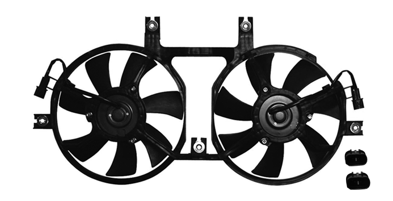

Sorry to thread jack a bit, but does anyone know if the front AC condenser fans are supposed to come on at the same time, or if they are two stage?
What I do know is I replaced a burned out fuse, the right fan spins, if I drive around for a few hours the fuse will blown again. I disconnected the left fan at the connector via left hand head light removed and reaching in, tested for voltage and nothing. I left it disconnected and it hasn't blown the fuse since. That's as far as I'm really wanting to diagnose the issue as it's a real pain to get at the condenser fans (chamonix bars off, bumper off) and I'm sure one is good enough for Canadian summers.

When the system is working properly the fans come on independently depending on the amount of heatload in the AC system.
One of your condensor fans is likely seized and is blowing the fuse when the temp sensors trigger the second fan to engage. The job isn't that bad to get at it but finding a replacement fan motor will be a challenge.
FYI: The motor casing is sealed and rivetted...100% non servicable.
I have one as a spare, got lucky and found a wrecked L400 in a local wrecker yard and could pull a number for you. The plastic frame was ruined but the 2 motors and fans were intact. The system can run one condensor fan but it does push the system to its limit to keep up on those really 'hot days'.
The UK wreckers can get you a used unit in short order. Take a look at the UK ebay pages. Thats where I get lots of my used parts when the local guys are empty handed.

That's what I'd figured, one fan to begin with and the second comes on depending on heat. I could only reach with the headlight out to disconnect the connector, I wasn't able to connect it to 12v to test if it runs. The fan does spin freely so its not seized. Had I of known, I had my front bumper off previously to try and get some measurements for a front winch mount, It was winter time and I hadn't tested my AC.Big-Bird wrote:When the system is working properly the fans come on independently depending on the amount of heatload in the AC system.
rivets can always be drilled out ;) I'll give it a shot opening it up and spraying it down with contact cleaner and some Glyptol.

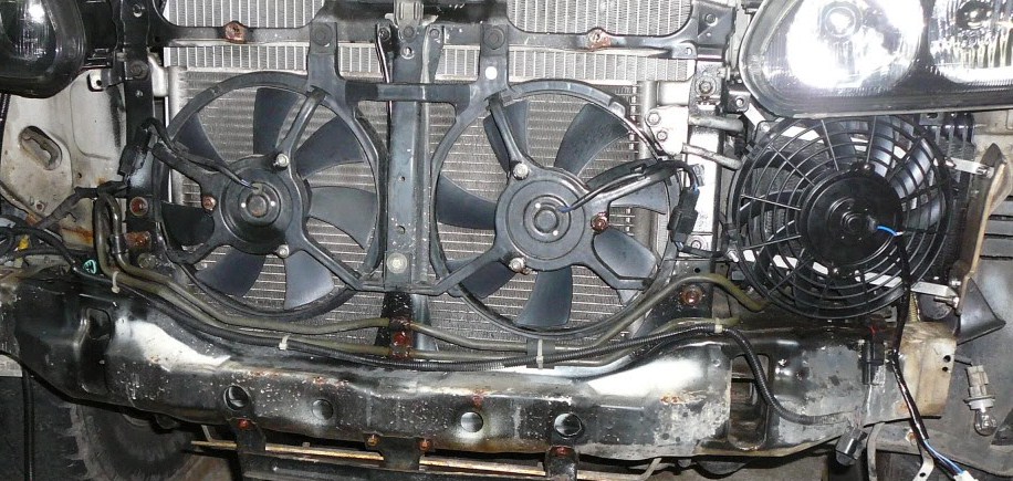

Big Bird
Great pic of the DIY condenser fan. That is on my list of "to do's" for this summer. Often wondered what it would look like.
TLWF
