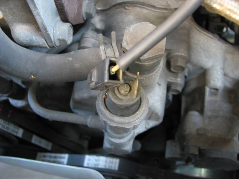

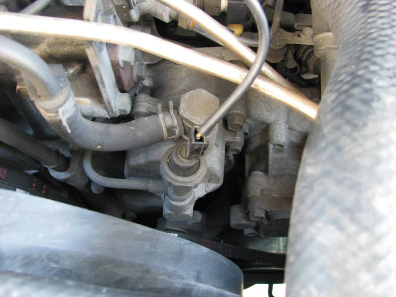

Can anyone name this clip? I found it when I was fiddling with my TPS and it is so loose it just slides off. If I hit a bump it would probably fall off. Not sure what it goes to or is for. Just wondering if I can cut it off and get a slide on connector from CT to replace this one. Thanks

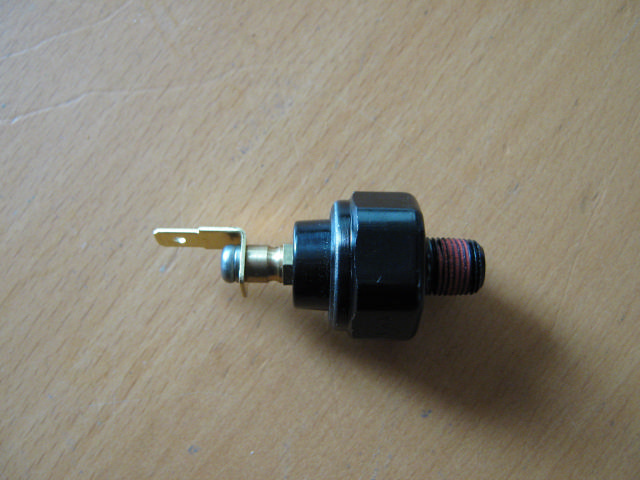

That's the oil pressure switch connection.
Most of the time old one is too loose to hold.

So Steven can I just replace it with any old slide on clip? I was going to cut the end off and crimp it into a new slide on clip.

I did exactly that Craig. Just crimped on a new female spade connector...10 seconds and good as new.

X2.psilosin wrote:I did exactly that Craig. Just crimped on a new female spade connector...10 seconds and good as new.

Right on - Thanks guys. Finally something I know I can do!

I did it and it worked out no problem. Thankspsilosin wrote:I did exactly that Craig. Just crimped on a new female spade connector...10 seconds and good as new.
