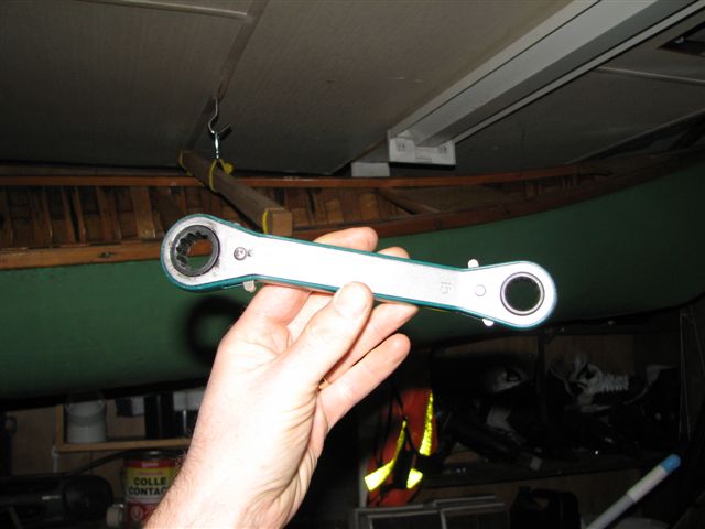

Cranked the torsion bars - found ratchetted closed end wrench from Canadian Tire ($14) was an awesome tool to get this done with. Very quick.

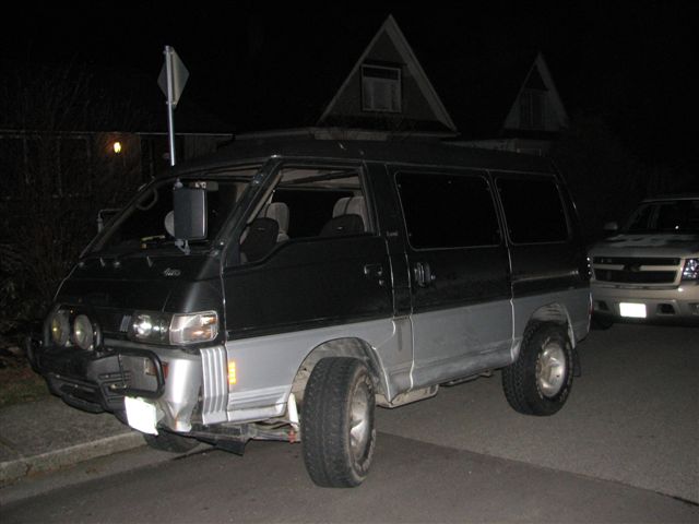

Trimmed out the fender well front and rear.
Put the 31" on - everything going well.....very happy.....then tried to open my sliding side door.....found out I don't have the extended sliding door hinges. I had read about it - but totally forgot to check clearances.
Fortunately it's still usable, but binds a bit and something I'd like to fix.
Exceedus Maximus is dirty - but had to post some pics...today was a GOOD day...
Does anyone know how I can get the extended hinges that are apparently on some vans that cross the pond?

- Will clean later and get better daytime photos up
- Delica 004.jpg (39.17 KiB) Viewed 14389 times
- $14 at Canadian Tires, makes the cranking easier..not easy, just easier!
- Delica 002.jpg (40.43 KiB) Viewed 14389 times

I have one of these on the Mystery Machine. Took me quite some time to source one!jrman wrote:Does anyone know how I can get the extended hinges that are apparently on some vans that cross the pond?
Tks.
I am going to have to space the hinge on the Mud Monkey when I fit new wider rubber - but have an 'alternative' plan which I am pretty sure will work just fine for you (and is a lot cheaper, easier and no cutting of bodywork involved!)
Remove the interior panel along the back quarter (the panel where the rear speaker is covered). Once removed, you can access the mounting bolts for the sliding door runner.
