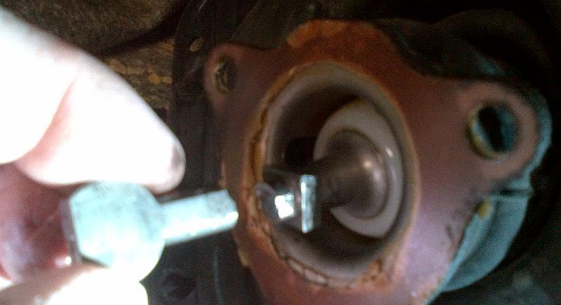

Here's a first for me. The t-case lever linkage broke today. I suspect a pin fell out when I shifted into 4WD mode. I have never had this happen on any 4x4 i have owned.

Have the new switches.
Now i need a warm day. Started snowing the day I was gonna roll under my Deli on the creeper. The lnikage is not borken thankfully, just a pin fell out. Still tight work space. Probably gonna have to lower the tranny and engine to make some hand-space at the tranny tunnel.
(not a fun job!!!!)
(not a fun job!!!!)

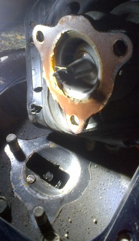

Got the t-case lever opened up today.......not good. Cracked and broke the end off. Need a new t-case shift lever now.
Thankfully it was easy to remove and the carpet didn't need to be pulled to do it. With the e-brake unbolted and moved aside it gave adequate access to the 6-10mm bolts that hold the boot in place and the 3-12mm nuts hold the lever and plate to the top of the transfer case.

You must shift into 4x4 with great enthusiasm ;)
I'd just weld it back together or ask a welder to do it.
Should take only a few minutes.
