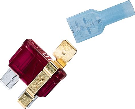

Another easy way to tap into a Hot-on-Run circuit for DRLs that is completely reversible and requires no messing with existing wires is to locate a suitable circuit in the external fuse box and use an ATC parasite tap. Something like the 'charging' circuit but it can be anything that is 12V when key is in teh on position and 0V in any other position.
Normally you would install the tap on the side of the fuse before the existing load and add another inline fuse for your new circuit but you can install on the fused side for simplicity because you will not be drawing much current to power the relay trigger or LEDs depending on how simple of a setup you go with.
Those options would be
1) power LEDs directly, normally would never do this but LEDs use so little power you could; DRLs ON whenever car running.
2) power LEDs through single relay, circuit used for the relay trigger; DRLs on whenever car running.
3) twin relays, second relay wired into headlamp circuit and cuts power to DRLs when turned on; DRLs ON whenever headlamps OFF)
claude
Posts: 189
Vehicle: Delica Exceed jasper
Location: Gold bridge BC
Re: Weird healight problem
Post by claude »
psilosin wrote:Another easy way to tap into a Hot-on-Run circuit for DRLs that is completely reversible and requires no messing with existing wires is to locate a suitable circuit in the external fuse box and use an ATC parasite tap. Something like the 'charging' circuit but it can be anything that is 12V when key is in teh on position and 0V in any other position.
thanks a bunch
