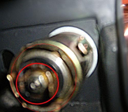

Thanks for the tip Kevin. I'm trying to remove it with taking apart the whole dash, but it's tough just feeling the nut. Is this it?
Sorry about the quality of the picture, I had to stick my digital camera inside the dash and take the picture looking out to get a better idea of what's holding it on there. Wasn't able to loosen it with my hands, so I might pick up a small pair of channel locks from crappy tire to stick in there.

Cool though, that must be a small camera to fit in there. It's not the nut in the center of the red ring, but the outer brass ring, which unscrews, marked here by a thinner red circle.

I can grab it, I just can't twist it. Tried quickly to fit a pair of pliers in there to grip it but no joy so far. Gave up, went climbing and swimming in the river. I'll try again tomorrow when I should be processing satellite imagery :-)
