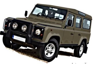

After a few weeks of personal debate about what to do about dings, (major) dents, rust spots and scratches on my van, getting a couple of quotes from body shops, and comments galore from various other owners I've decided that the most productive approach is to do my own body repair work and roller paint my van.
My rationale is this: its a utility vehicle. Its going to get more dents, more scratches. My primary concern is protecting it from rust. I know a wee bit about paint prep. I like the military paint scheme. The Land Rover guys have been doing this for years... You can probably already see where I'm going with this.
So I started searching online. I've only found a couple of paint suppliers so far that specialize in the military color scheme:
http://www.paintman.co.uk/paint-colour- ... ies-2.html
http://www.armyjeepparts.com/order_page ... ttom_1.htm
Linkback to related thread: http://www.delica.ca/forum/paint-job-question-6593.html
So the van is going into the workshop in a week or so for some overhaulin' (electrical & alarm system, suspension, insulation/flooring and of course body/paint). This thread is for the latter.
I'll start with prep as this is the most important part. Photos to follow in thread...

Right decision! Can't wait to see the whole van covered in military green

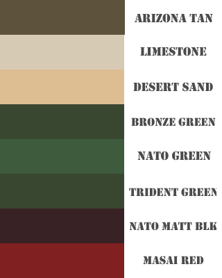

Check out the color palette tool on the landy site I linked. There are some other mil colors that are similarly appealing.fexlboi wrote:Right decision! Can't wait to see the whole van covered in military green
UPDATE: see also this link for Canadian Army colors.

Agreed!fexlboi wrote:Arizona Tan and Limestone are great too!
