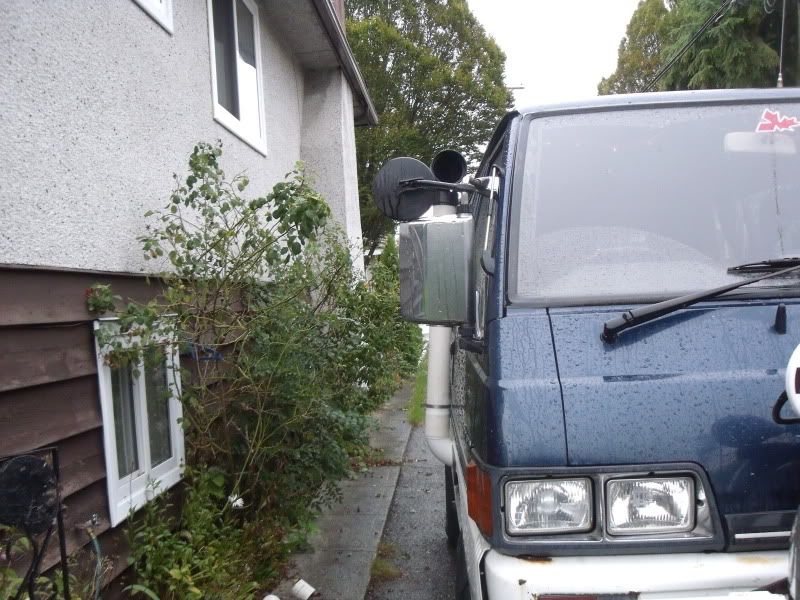

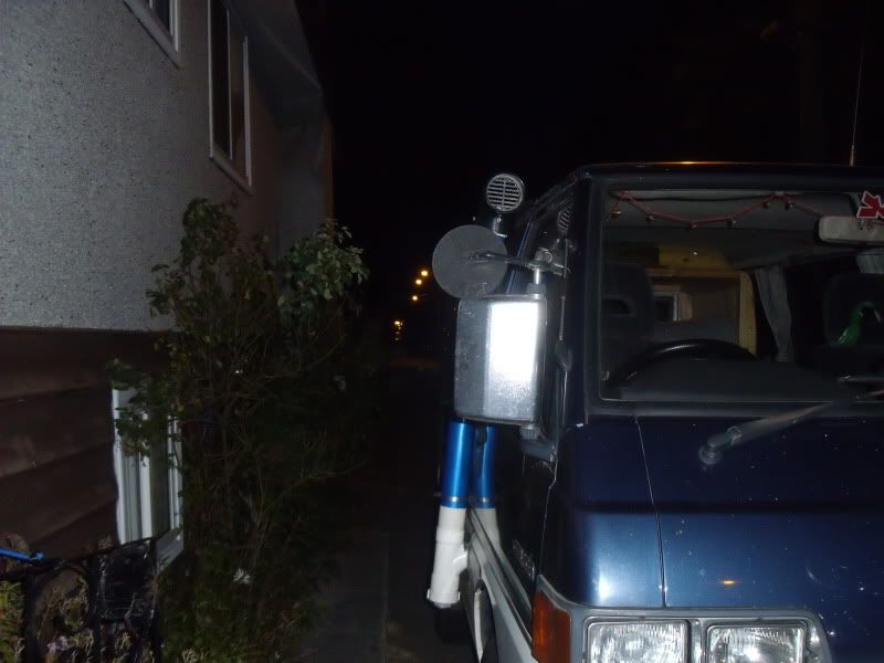

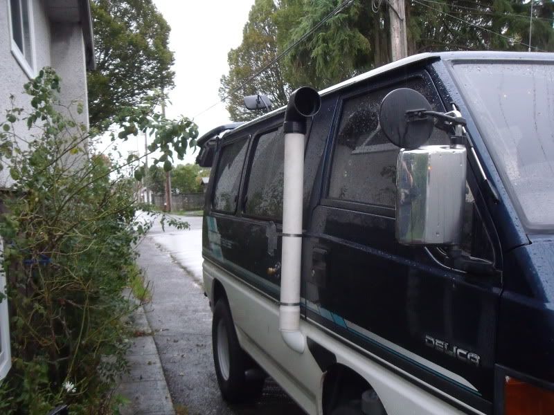

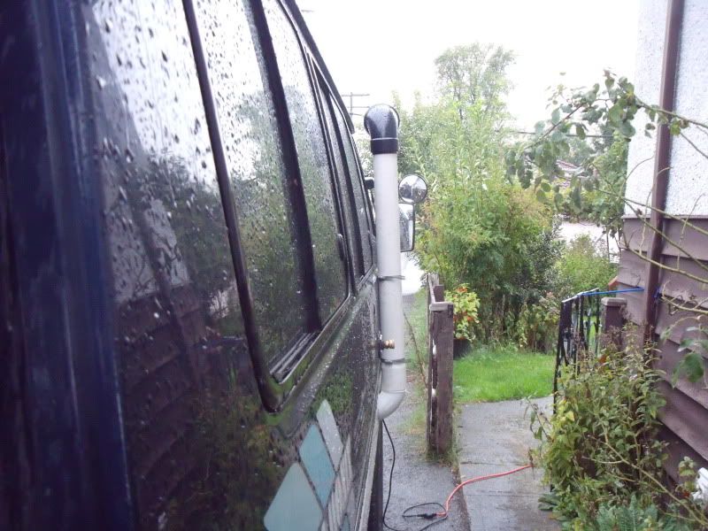

Just need to weld up a new input into the airbox, connect, and urethane the body/pipe hole.
(I may bend it to follow the body line a little more)

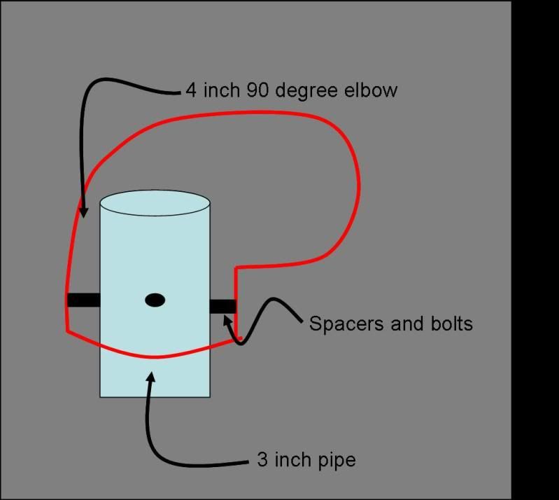

It's the $40-70 problem...Think I have an idea, just need some time!jfarsang wrote:Or just do what many others have done on DIY snorkel's. Put on a Safari head. $40-70
