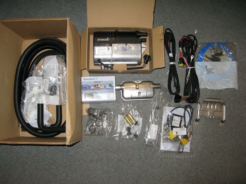

I'm going to install an Espar Hydronic 4 heater in our van. Received the package last week. It's now just a matter of time to install the thing. Main reason for Espar vs. Webasto is the excellent availability of parts worldwide as well as the heater works in high-elevations with an additional kit.
Beside hot air we also want hot-water for a shower therefore a coolant heater was the way to go.

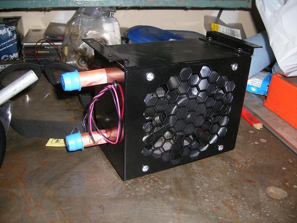

From what I understand, then Hydronic is a coolant heater for the engine, not air for the cabin.

Either I use the little radiator I took out of the rear heater assembly and build a box with a little fan. Or I go the lazy route and get the smallest coolant 12V auxiliary heater from Princess Auto.
http://www.princessauto.com/trailer/tru ... ary-heater

Just in case someone is also interested in this coolant heater from Princess Auto. It is on sale till Dec 5th.
So I guess I'll go down the lazy route

Wouldn't running that coolant heater drain your battery by the morning?

This coolant heater draws about 35 mA, so don't worry about draining your battery

Ups. I actually meant .35 A
It's still irrelevant with a 80Ah auxiliary battery. You run it only for a few hours anyway.
