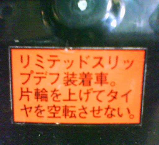

I have LSD and it is signified on my '92 Chamonix GLX by an orange/tangerine sticker with black Japanese writing on the bottom right corner (as viewed from the seat) of the driver's door, on the inside edge and looks like this:
LSD uses a different fluid than standard differentials.
