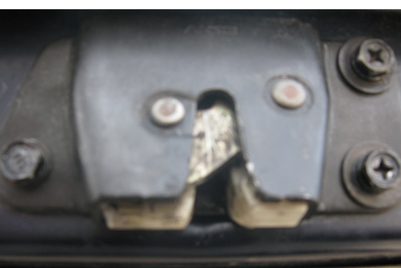

I have a problem with my tail gate lock. See picture.
The lock will not catch on the ring on the floor of the van. Therefore it will not lock. The tail gate bounces off the catch ring. I have lubricated the lock and the internal springs and all hinges. Still nothing...
Any suggestions? I have looked on the forum and it seems nobody else has had this problem.

looks like it is already closed, put a wire hanger, or screwdriver in there and pull while someone is pulling the release handle.
Re: Tail Gate Lock Problem
x2
Catch ring is in the closed position.
Pull it out to open position.

Yes I'm new to this upload download thing... Whatever. The rear lock is fixed! Thanks to the forum.
