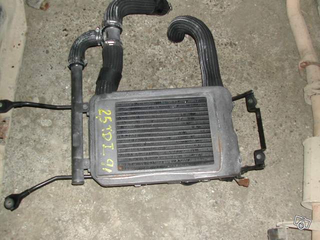

THe title says it all.
I got an OEM pajero intercooler to install into my strada.
Would i need to change anything?
fuel pump flow rate?
injector pump flow rate?
connect intercooler fan wiring to where?
do i have the same ECU as the pajero(doubtful) would my ECU be able to control my fan or should I just bypass the ECU and use an inline fuse and temp sensor to control it?
any feedback is good feedback.

Re: oem pajero intercooler into a strada ( is tuning necessary?)
So, cleaning of the intercooler has begun(anybody have a good way to clean the inside of the rubber hoses, not sure if diesel will eat the rubber or not). I'll be finding the optimal position for it in the strada this weekend. I've always had the question 'what is the tube attached to the bottom of the cooler for???
my only thought is it creates a pressure bubble the main air flow has to get accross creating turbulence(rough air flow) throughout the system. And I believe that would increase the cooling rate (compared to smooth(laminar) flow).
I also found a pic today of a setup without the tube(I don't think it had a turbo, wierd). can't seem to upload it but you get the drift.
anyone have any other thoughts why the tube is there?

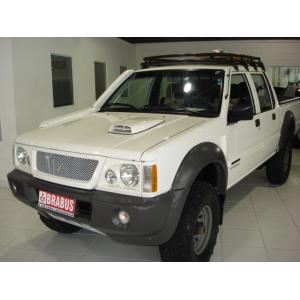

For the hood scoop,check on e-bay.I bought mine from Australia,Ebay member bosso_1.The name of the item is:
Bonnet scoop fibreglass GU Nissan patrol Multi-fit.It cost me around 150$.
Okay, I just checked my '94 SWB (Generation II Pajero) and it too has that 'extra' pipe off a junction. I didn't take fluid dynamics, but I do remember reading somewhere that when a fluid hits an obstruction a shockwave is sent back along the direction of flow, looking for an easier path. That branch could be an 'out', thereby not disrupting the flow from the turbo to the intercooler. Or, it could be acting as a sort of accumulator, storing extra pressure for when the turbo spins down momentarily, like when shifting gears. But I'm just spitballin' here...
As for the intercooler fan blowing 'out' when it comes on (remember, it's underneath the intercooler and apparently blows upwards when it is fired off), this makes sense, from a cooling perspective. So, your engine is hot, probably because you're lugging along, slowly, without much airflow through the louvre (hood scoop), down through the intercooler and across the engine. The fan kicks in, but it's not for the intercooler, it's for the engine. And which way does it blow the hot air surrounding the engine? Upwards and out through the hood scoop, drawing cooler air from underneath the vehicle, up over the engine, cooling it.
Finally, as far as 'tuning' the engine after installing the intercooler, what little I've read up on intercooling, you may have to increase the boost a bit to compensate for the extra distance the air has to travel to get to the intake; and you may have to 'up' the injector pump a bit because now you're cramming more air into the engine. More air compared to less fuel - it's going to burn lean, less power, white smoke.
But I'm no mechanic, so we should probably get one or two of them to chime in, or at least someone who might have done this sort of thing before.

How does the old strada look with a hoodscoop??I currently like the look of mine without one.
I was correct: the 'extra' pipe on the intercooler is a dampener or muffler. This would explain why a GenI Pajero doesn't have it, but a GenII does.
As for the direction of the fan, when it gets too hot, it's to blow hot air out of the engine bay, not cool the intercooler. I agree, it would be pointless to blow hot engine air through the intercooler, but I don't think that's the intent.
Be sure to take some before and after pictures so the rest of us can see how you did this. Should be interesting.

I can't send you a photo of mine with the hood scoop 'cause it is not already painted.
But check on the web for a Mitsubishi L200 Savana 2000-2003.It's the brazilian version of the
Strada.It come with an intercooler and factory equipped for true off-roading.Really nice.
Here a picture.
