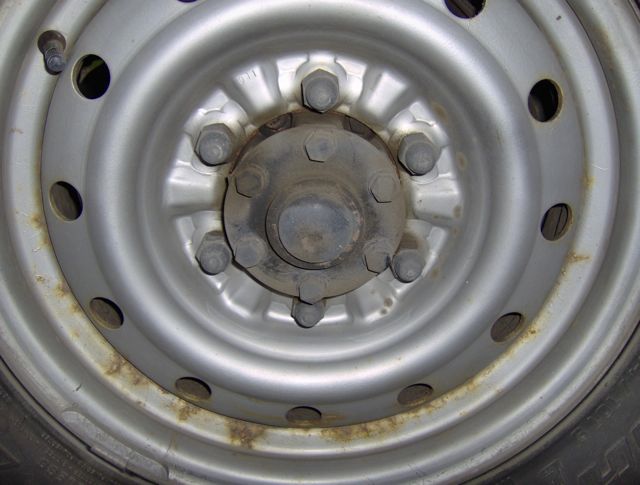

Ok, my wording wasn't quite right, but the end result is the same. The L400's front wheels are permanently connected to the front axle, regardless of which mode you are in, as such, even if you are in 2 wheel drive the front wheels still turn the axle, which turns the front driveshaft, only at the transfer case is it disconnected.
from the factory the L300 has auto-locking hubs. the L400 has flanges. yes I'm sure.

My L-300 came from the factory with flanges - I switched em out for manual lockers...Green1 wrote: from the factory the L300 has auto-locking hubs. the L400 has flanges. yes I'm sure.

Are you sure it came from the factory with flanges? I'd guess that it had auto hubs from the factory that were swapped to flanges by a previous owner.My L-300 came from the factory with flanges - I switched em out for manual lockers...

From the factory... I'm sure too. There are a few other out there like that as well - A low end option I guess.

Flanges were not a factory option on the L300's because of the 4WD system.
Flanges were a factory option on the L400's because of the AWD system.
If an L300 came to Canada with L400 flanges, it was installed after its initial sale.
If an L400 came to Canada with auto/manual hubs, it was installed after its initial sale.

With all due respect - and that is a whole lot..., that is incorrect... The flanges on my 300 were factory and they can be found on other 300's too. Rare, but they're out there.

How do you know that they were a factory part rather than after market?konadog wrote:With all due respect - and that is a whole lot..., that is incorrect... The flanges on my 300 were factory and they can be found on other 300's too. Rare, but they're out there.
