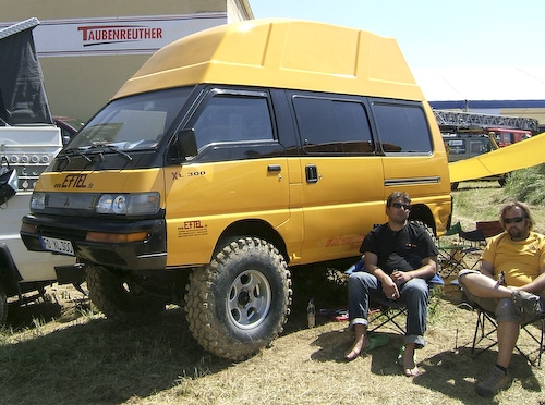

Felix posted a youtube clip of a yellow lifted L300 with a hightop I believe. It tipped over on it's side while the camera man expressed the 'S' word in German. :-D

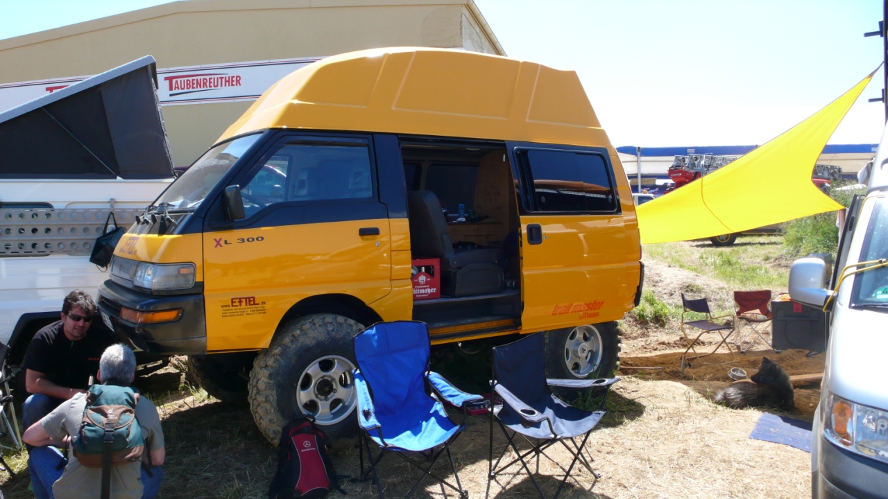

This is the big yellow beast in question.
http://www.youtube.com/watch?v=cMtSape57rU
Anyways, these are a few pics of it I found in one of my
caffeine hazed delica searches,you can see the top a bit
more and there is a bit of an interior view.
I think these pics were taken soon after the vid
,note nice dent in the port quarter!
Looks like the made sure they brought enough beer too. :-D
big yellow.jpg (173.9 KiB) Viewed 5452 times
bigyellow 1.jpg (394.73 KiB) Viewed 5453 times
I personally think the sail area would be scary and awful in a good crosswind,
especially on a lifted unit.
