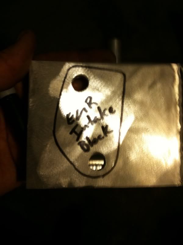

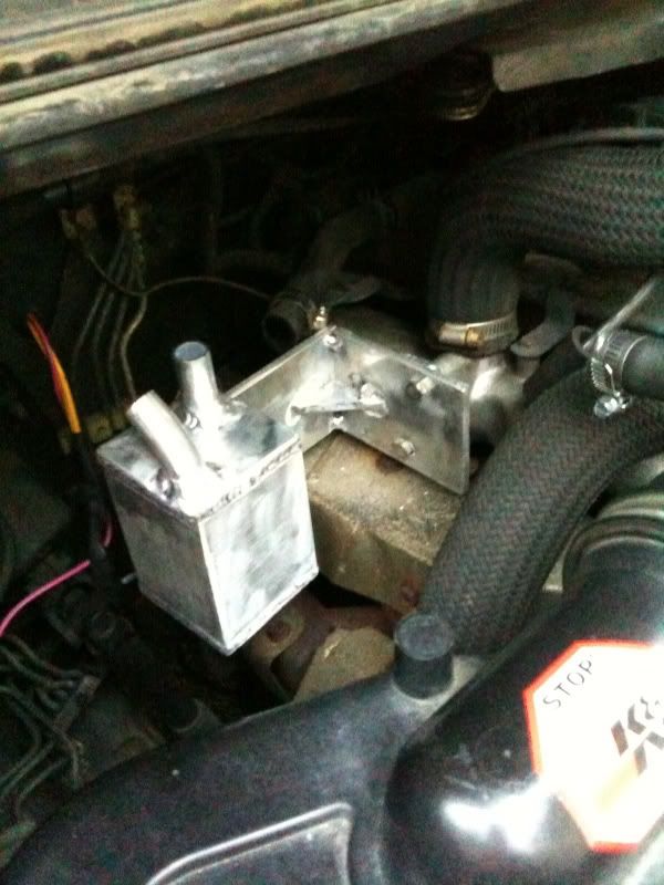

I mounted this to the EGR blocking plate and caped the end that was an inlet to the air filter tube.

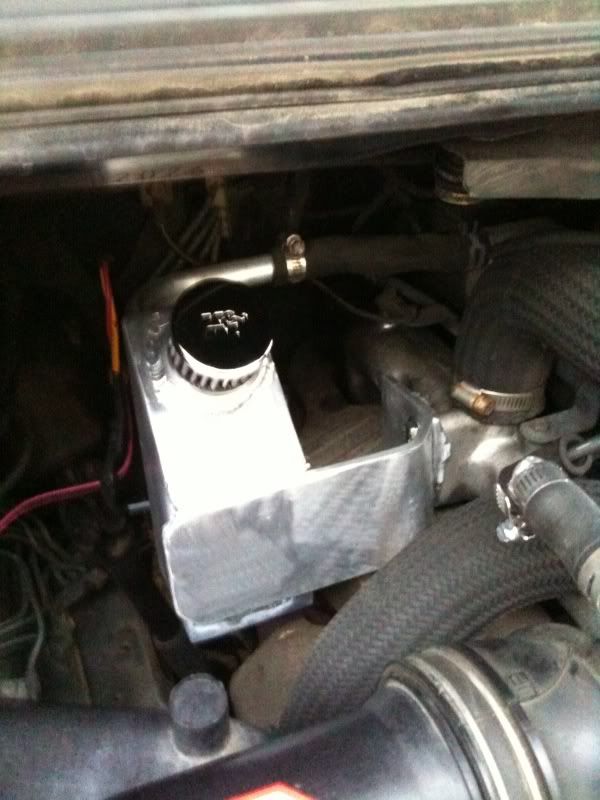

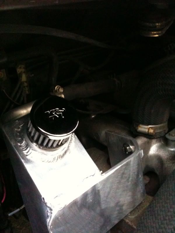

Then I thought what about making a 2fer double duty job out of it, so I made the following , why not make the mounting plate for the Catch can into the Egr blocking plate, so thats what I did, took a cut off some 1/4x6x20 cut it down and made the egr plate cover, and also made it into the bracket for a catch can, I put two pieces of 3/4 round tube onto the top, so one can be an inlet, and the other can either be a mount for a breather filter, OR it can continue to be sucked out from the turbo suction as it was designed from the factory but the catch can will keep the drippings , I think it should take over 5 years or more to get an amount of oil in the can to warrent taking it off to drain, after all its vapor. but I still dont like my turbo to be covered in oily crud, the intake manifold gets it also from the turbo end and its pretty filthy oily, it should dry up in a few weeks .
I was thinking about making a few up as combo units with the exhaust egr cover also, what do you think?
Tell me the truth, I want to know what you all think.
