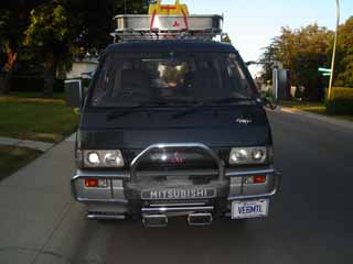

In the picture you show in your post, the lenses of the lamps are clear. Fogs have amber lenses. Are the bulbs amber? The reason fogs are amber is because amber light bends differently from white light, enabling you to see better through the fog, where white light bounces back off the fog. Just thought I would mention that.
P.S.: The centres of your fog lamps must be lower than the centres of your headlamps. The stock ones are half an inch lower.

Ah Falco, you just HAD to mention the colour of fog lamps didn't you? ...wait for the response from Green1...
The jury is split on the colour, but placement of fog/driving lamps IS important and I concur: mount them lower. And by law, in BC at least, any lights ABOVE your headlamps are supposed to be covered when on public roads.
