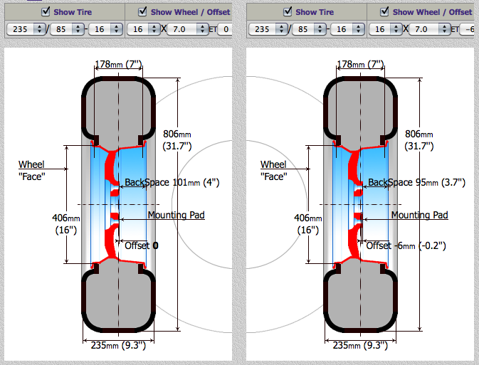

Re: Tall and narrow tires
Thanks guys! My first choice are the 235/85 Firestone too.
Toyo is interesting, but it seems there are not everywhere available which makes them a no go for travelling.
Meanman, it looks like the 31x9.5R15 is pretty rare. Could not find much information/tire option with this size. 33" would be too much. Narrower tires are leave bigger footprint for sure, but I'm not too worried about that if you drive carefully.
Now in terms of rims we could use either 16x6 or 16x7 with 4" backspacing. A few post on this forum recommend 15x7 with 3.75" backspacing with a 31x10.5R15 to gain maximum width (for car stability) without the sliding door rubbing on the tire.
This is now a 16" with a narrower tire. Are there any difference in terms of backspacing?
Also because the Delica has fender flares, would it be possible to go even further out?

- calculator.png (97.97 KiB) Viewed 10496 times

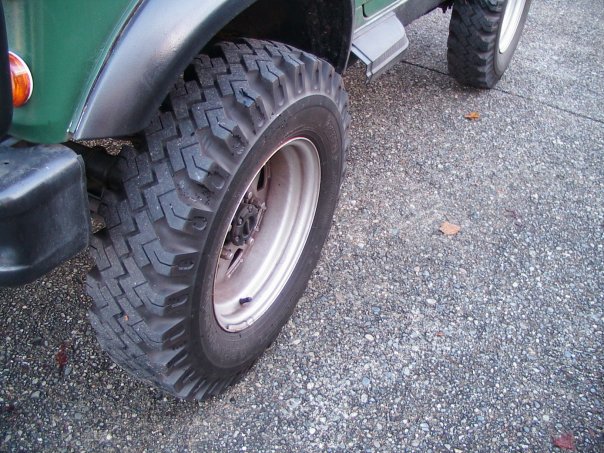

If you really like narrow (great contact pressure), you should go for 7 x 15. Only Yokohama makes this size in radial now. I had Bridgestone Jeep Service on my Suzuki (now history); they were the greatest mud tires.

Anybody know more about my backspacing question?

As for backspacing, I would go wide enough to get the tyres just to the edge of the flares. Make sure they don't stick out past the body panels. I am currently running 265/75/R16's on my van, and with the lift (about 4 inches) there is still some rubbing that needs to be addressed with some panel trimming. I prefer to keep the tyres inside the wheel well to ensure there is articulation the full depth of the wheel well.

16x7 with 3.75 or 4" backspacing with 9.5" wide tire will do.
You can go 3.5 " backspacing as well

Alright so now it's time to find a good price for Firestone Destination M/T 235/85R16 with 16x7 rims and 3.5-4" backspacing.
