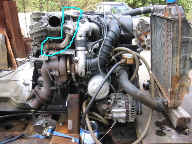

okinoerabu
Posts: 1
Joined: Wed Aug 29, 2007 7:56 am
Vehicle: P04W 4D56
Re: Injection Pump Question - What's this?
Post by okinoerabu »
I believe that item #3 is a throttle position switch which provides control to the EGR valve. I bought a JDM engine to put into my '90 P04W which is the 2WD LHD USA version of a P25W Delica and the engine had EGR and device #3. The EGR is vacuum operated and would be controlled by a solenoid actuated valve. EGR stands for exhaust gas recirculator and the actuator is on the top-aft of the intake manifold. It can be disabled without adverse affect and is what they are disabling in the get rid of the black smoke ads. Disabling consists of stopping the exhaust from entering the intake air stream.
