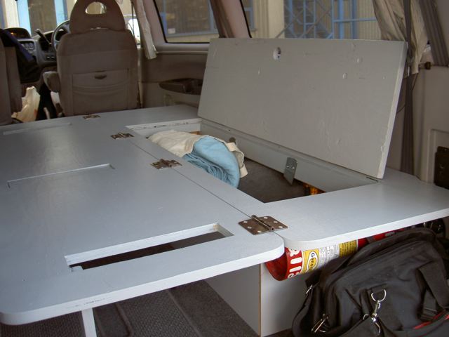

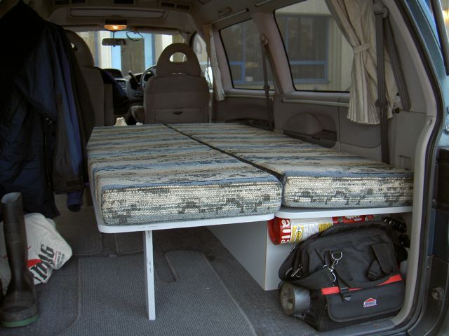

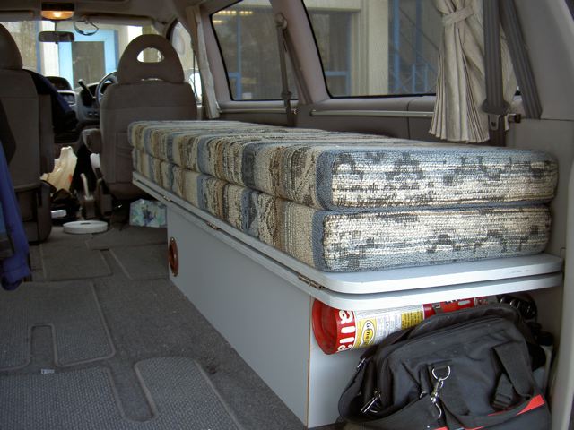

I don't need a full on camper as I have a motorhome, but I do want to be able to "weekend" (with company) in my Deli.
So, here's the start...
The bed is made with good-no-side, leftover, used 3/4 plywood and cushions leftover from my last van. But the paint is new. :-)

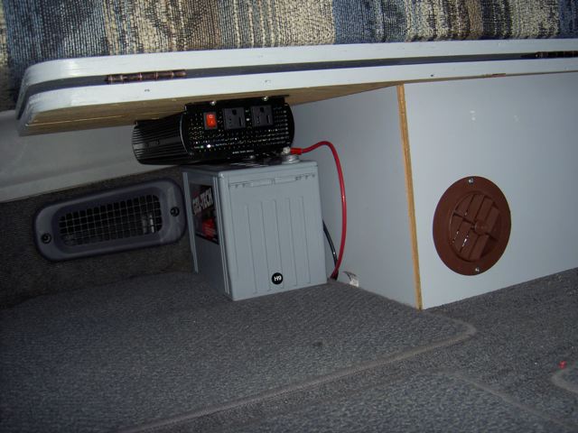

The battery is a Gel as recommended by Polar and a 1000 watt inverter. The battery hold down is still in the design phase as is the "slide out kitchen".

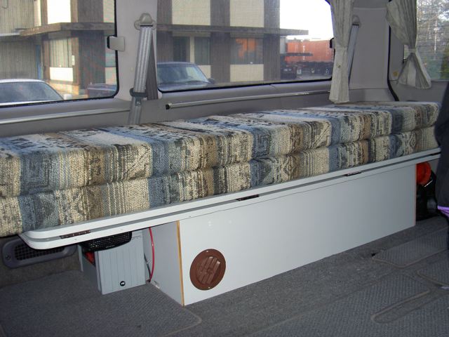

Nice.
Vent ... espar or webasto ? :-D

i like the fact that your wood is all painted white. really brightens things up!
How many amp hour battery did you buy?
look forward to sseing more of your project...

Nope, just an extension of the rearmost heater outlet.

Funny lighting I guess. I took those pix during the milliseconds of sun yesterday. The paint is actually grey, but lighter than the gray of the interior...
The battery is a 70 AH
