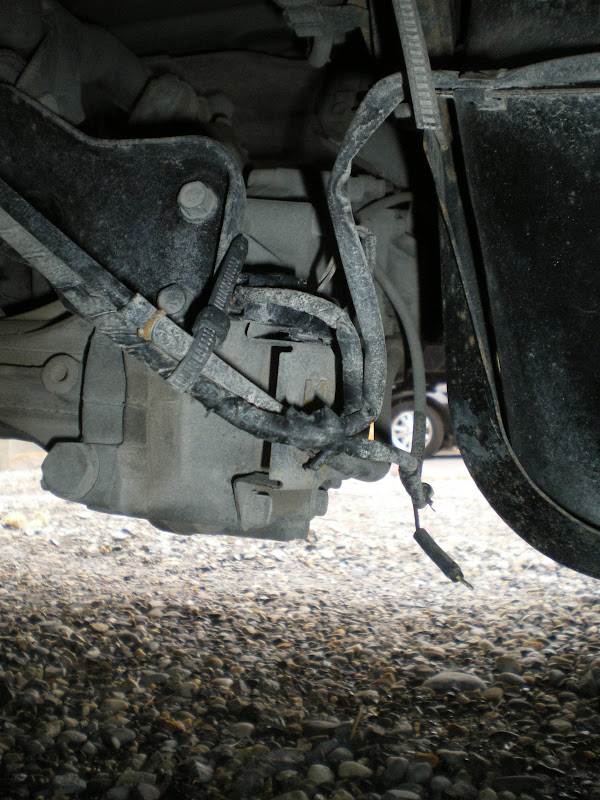

Hi guys, I was crawling around underneith the Deli today, noticed this cut wire.
It's located just under the side step bar, middle of the van, night near where the front drive shaft enters what I guess might be the transfer case??
It's a red wire which leads to a little connector, then the wire becomes yellow, then its cut.
Pretty sure I read about a yelow wire being the cluprit for 4x4 and maybe locked hub lights not working - both lights for me stopped working about 1.5 years ago.
Before I take the time unravelling tape and trying to reconnect this wire - could someone perhaps confirm if this in fact the 4x4 and/or wheel lock light wire for me?
Thanks very much
Steve

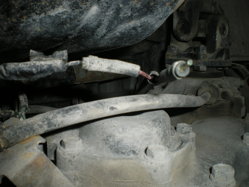

This shot is from directly under the break. Blurry part is in fact the cut wire and I think it should be connecting to the taped area to the right - where the other wire is running to...

Found this post regarding wiring - looks like it's the wire to replace...
http://www.delica.ca/forum/4wd-indicato ... r-900.html

ah hah! thanks for the replies in this thread, i have been wondering about my flickering 4x4 light for 2 years. now it's fixed!
