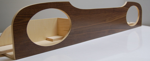

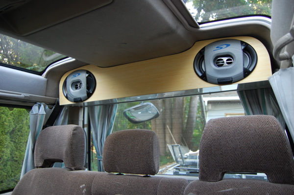

I have a pioneer head unit (with usb connectivity)with a set of alpine type R 6x9's in the back and I swapped out the in dash speakers with smaller type R's as well. While still a very entry level system, it is light years ahead of what was there. It's also nice to get the rear 6x9's up to ear level, and not bury them somewhere in the back.
I made a few extra of these when I made mine, so, If you have a crystal light roof model, I have one in walnut (pictured below) available now. Here is the original post from this if you are interested.
http://www.delica.ca/forum/still-availa ... -6304.html
Glenn

glenn wrote:I have a pioneer head unit (with usb connectivity)with a set of alpine type R 6x9's in the back and I swapped out the in dash speakers with smaller type R's as well. While still a very entry level system, it is light years ahead of what was there. It's also nice to get the rear 6x9's up to ear level, and not bury them somewhere in the back.
glenn,
yes i saw your 6x9 eclosure creations on another thread. :shock:
the space between the speakers just screams for a storage space with a door or something... LCD screen maybe?? :?
Unfortunately, i don't have a crystal roof. i guess when i bought my deli, windows in the roof weren't a priority.
if you had a unit for a high roof, i might be interested.
al
