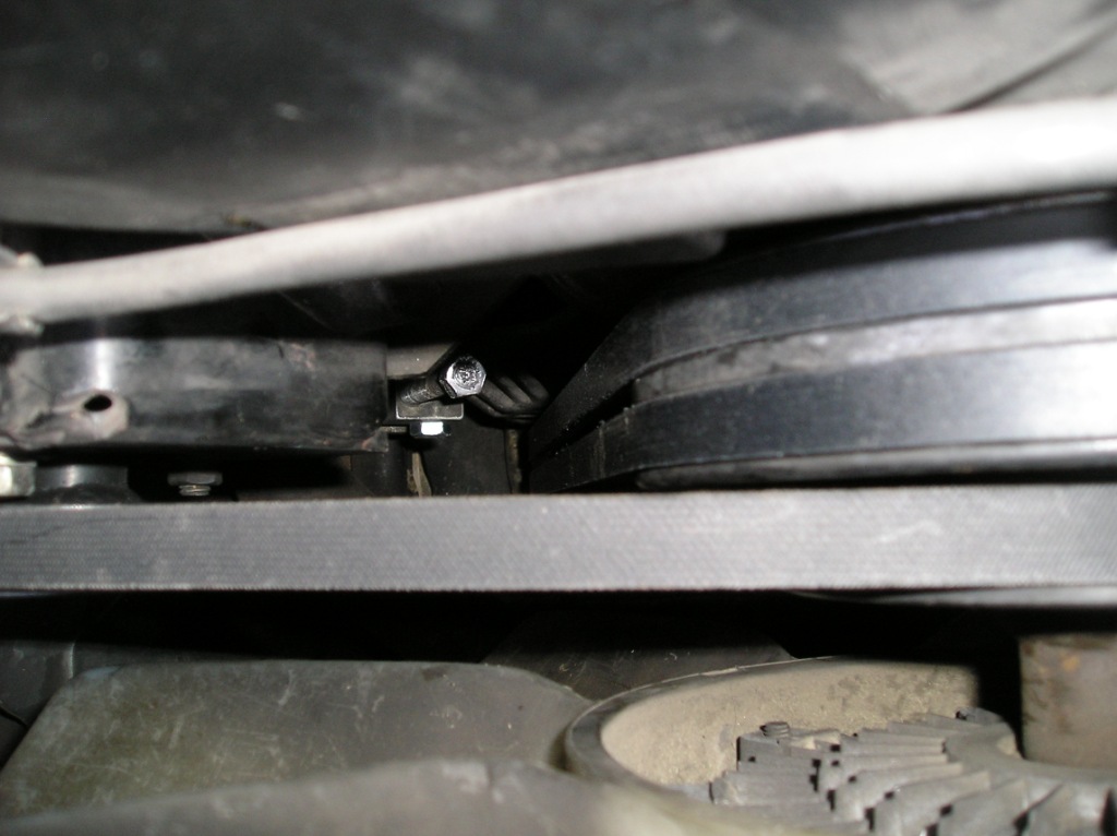

I ran a nut onto the end of the long threaded adjustment bolt and drilled and pinned it so that I could turn the adjustment bolt from the engine end rather than the wheel well end. Works great. Can't imagine why the manufacturer didn't produce it this way. Of course the locking bolt and pivot bolt need to be loosened before adjustments. The photo is taken looking down from the passenger side.

Wow, great idea. Thanks for posting pic's of your maintenance to help others, keep doing them.

philstade had a great idea. I had to tighten my belts and after the under van route a few times I was determined to do it from the top. I removed the cowling and fan blade and thought I could reach the bolt to tighten it. It did not work with about every kind of wrench you can image. I remembered this post and saw the end of the bolt staring me in the face. I removed the bolt added a nut welded the nut on the end and had everything back together in a few minutes. Next time I need to tighten that belt it will be a nice clean 20 minute job. Why I didn't do it before is beyond me.

The stubby gear-wrench was one of many tools I tried. Glad you got it to work. I used most of my vocabulary as well as the stubby and I still couldn't get more than about a 2 click turn. You must be double jointed! :-D
