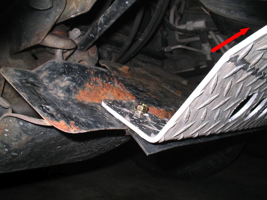

I don't mean to be overly critical, but the first thing I noticed about the skid plate everyone bought this past year was how it seemed to go all the way down to the 'scoop' in front of the radiator. And now that I've found the pictures, I've confirmed my suspicions. The double row of holes is at the wrong angle to allow enough air flow, and the lower single row of holes is too obstructive too.
The red arrow in the next image indicates where most of the aftermarket skid plates end.
I suspect that this particular version doesn't allow enough air flow around the engine bay - might be the cause for your overheating.

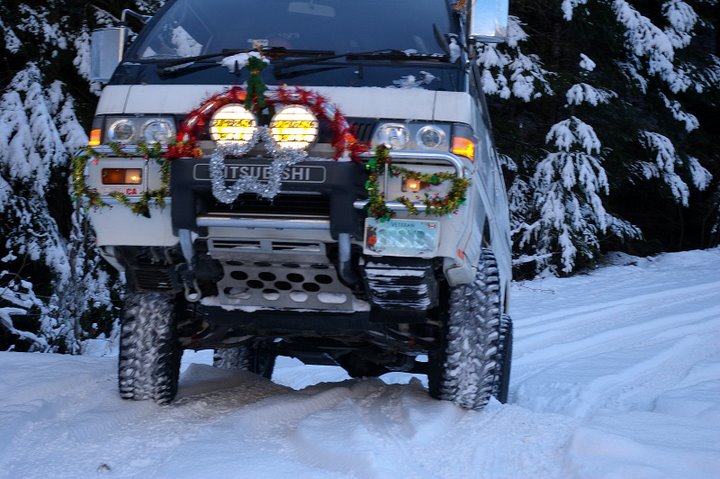

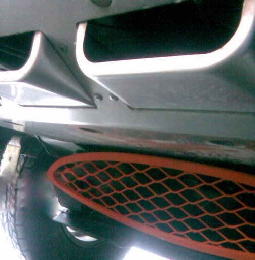

Here are two others that either end before the ram scoop or have sufficient-sized holes down in what I am speculating is a critical area for air flow:
- Big enough holes
- IMGP2608.JPG.jpeg (89.95 KiB) Viewed 8524 times
- Skid plate ends before ram scoop
- Image130.jpg.jpeg (45.68 KiB) Viewed 8514 times

I am inclined to agree with JRman & Konadog, that I don't think the skid plate is the culprit. The bottom picture is off of the Miss Lil' Bitchi and I was very careful to make sure that the grille was lined in the right direction but I don't think it really matters. One thing I think we should be considering is that it has been rather hot these last few days and perhaps this has something to do with the recent experiences of Delica drivers on our steep BC hills. Another thing that comes to mind: I'll bet that most of the drivers (like myself) moved to Delicas from gasoline vehicles and are driving in the same manner, which might have something to do with this... Just a thought.
Other possibilities: Rad; water pump; thermostat; fan clutch.
