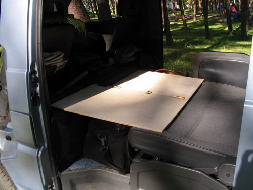

1. "soft" luggage is placed between the middle and front seats . From under the middle bench I pull out a "custom- made" piece of wood board to fit on the seat and centre isle ( how do you call this thing behind front seats anyway ? )
2. This is how it looks :

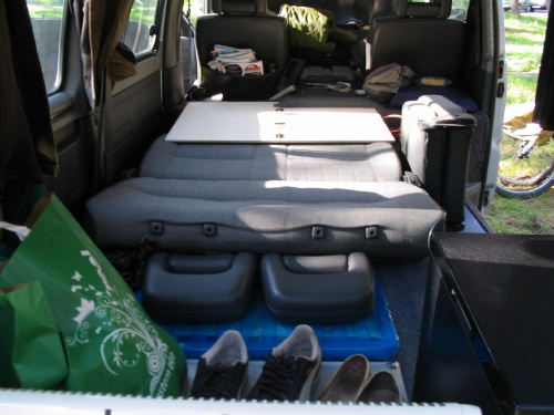

3. Lay flat middle seat. Jump seat remains folded. I put a flat box under the seat for extra support. Remove headrests ( they can stay, but then they raise up one end of the mattrace )

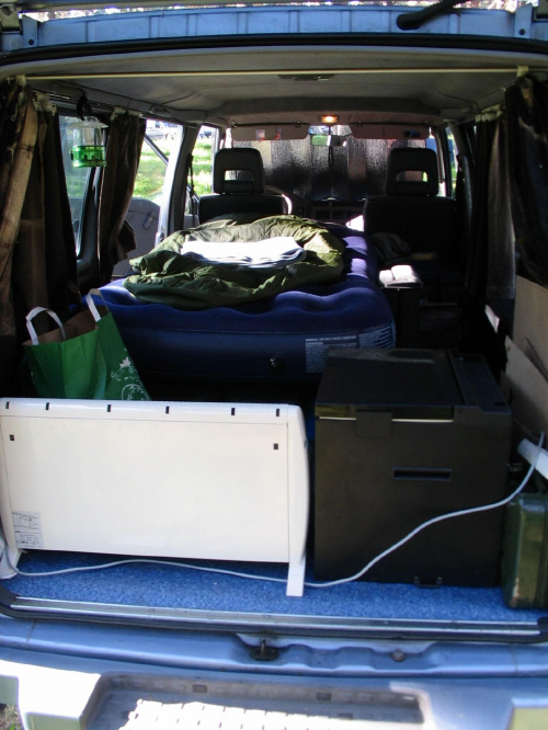

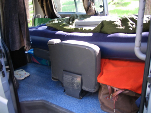

4. Inflate a nice comfy airbed ( double twin size, 100 cm wide ) and put on top :
5. slide the curtains and go to sleep :)

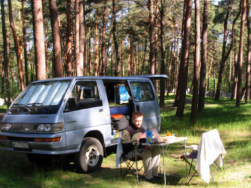

you can see a doble voltage fridge ( 220/12 ) and an air heater ( 220 ) - it was pretty cold at the sea side this spring !
There is pleanty of room around the bed to walk, change clothes, eat etc. if the weather is bad.

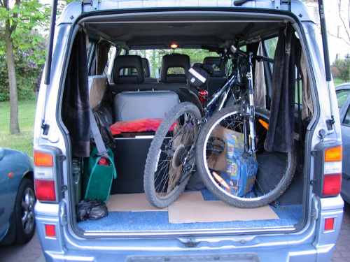

When the seat is up and frigde moved to the side 2 bikes can be accomodated inside :
