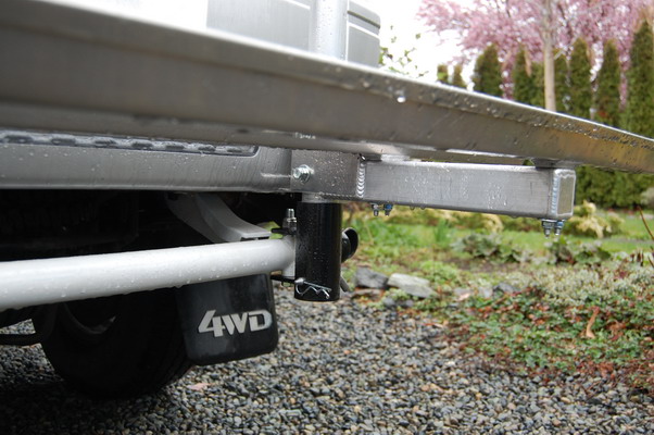

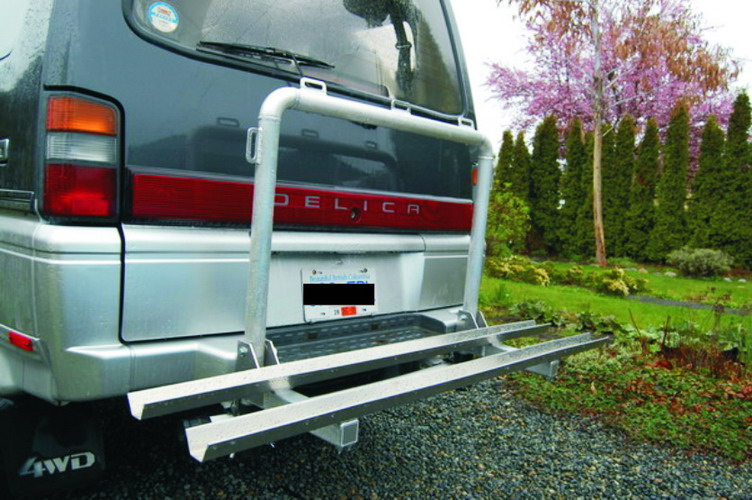

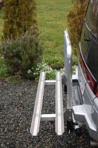

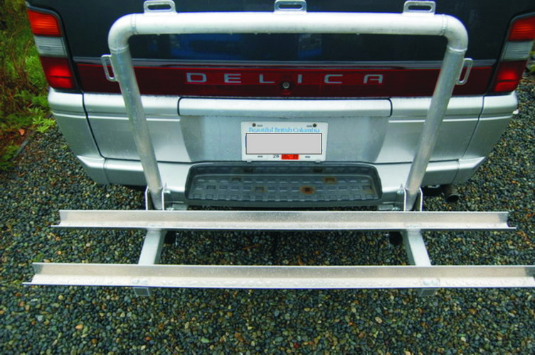

A friend of mine and I came up with this for a bike rack. The rack is solid on the bumper, but to be safe, the top eyes are to attach a strap from the top of the bike rack to the hatch. Others are to bungie bikes to the rack. Removal is a cinch - just remove cotter and pin and pull the rack out of the steel sleeves. The aluminum tubing makes for a super-light and strong rack.
Happy trails...

just a word of warning, that's not the bumper, that's the rear nudge-bar, and it has almost no strength, I wouldn't want weight bouncing up and down on that for very long, it's quite likely to break the nudge-bar...The rack is solid on the bumper

Don't want to be a party pooper, but I'm inclined to agree with Green1. I own a bike shop and have seen every "I-was-just-driving-along-and-my-bike-rack-sheared-off" catastrophe that you could think of.
Keep an eye on that nudge bar and NEVER EVER use it without the straps or you'll be dropping your precious cargo in the middle of some highway somewhere.

That's not the original bumper, is it?Green1 wrote:just a word of warning, that's not the bumper, that's the rear nudge-bar, and it has almost no strength, I wouldn't want weight bouncing up and down on that for very long, it's quite likely to break the nudge-bar...The rack is solid on the bumper

It's more of a 'show bar'. Not much strength in it.
The stock bumper (part of the body trim) is not much of a true bumper either.
Plastic and very, very thin tin-like metal is what protects the rear end.
Bolting to multiple parts along the unibody frame lengthwise is the best option. Most hidden hitch bumpers are made like that for the Delica's for strength.

What you can't see is the reinforcement underneath - definitely considered the potential of a mishap. I am over 200 lbs and I have jumped up and down on that 'nudge bar' for minutes at a time without it moving. The weight of the bumper coupled with the straps has me convinced that this will work just fine. I have a few modifications in mind, including an additional mounting point.
