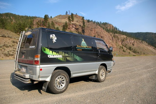

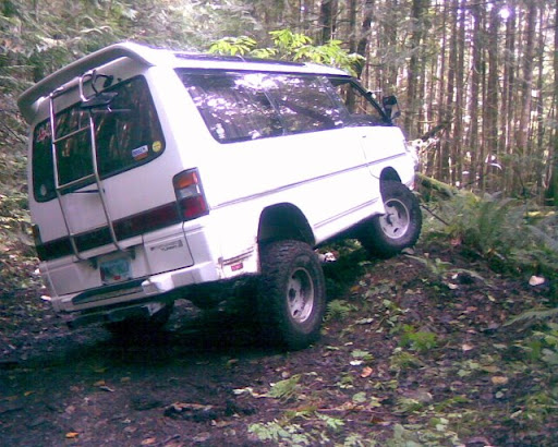

It depends on one's application. If you want to go off road then you want the big knobby tyres, and they vary in type. I use Yokohama all terrain Geolandars, these are the middle of the road, as it were. They are comfortable driving down the highway and also have a considerable traction on other surfaces, as well. DeliCat has great big mud terrain tyres that are very good for muddy situations, as well as deeper snow conditions. With my Yokohamas I get traction in lighter snow conditions and for deeper snow I have chains.
The Miss Lil' Bitchi's Yokohamas (with & without chains):
The Mitsushi's mud terrains:
Both have pros & cons ~ it all depends on what you want them for. When purchasing tyres one thing you should remember is that you are driving a truck and not a car, so you will want rubber that will support you in your endeavours... smiles.
