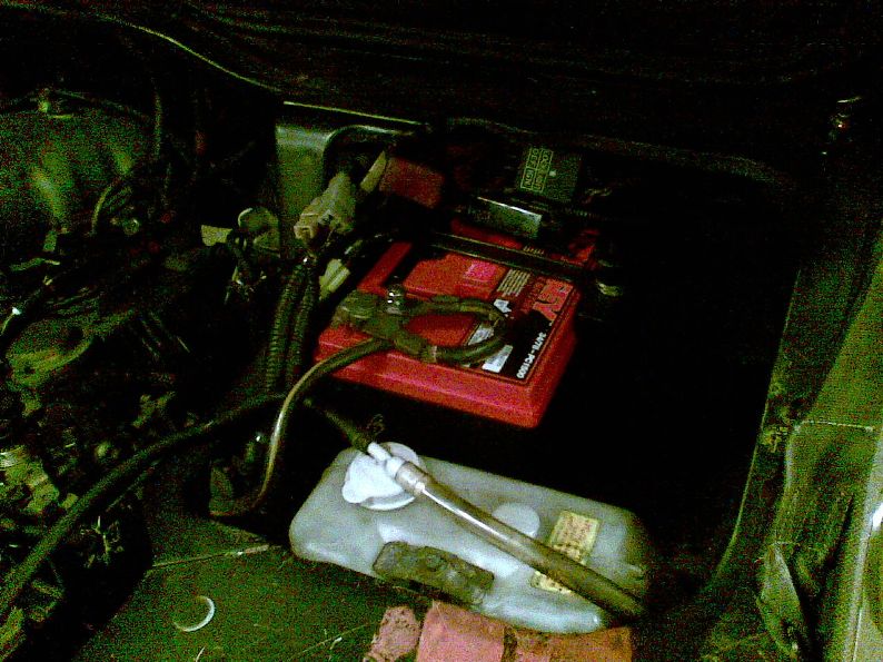

jfarsang wrote:I went to Polar as well. Have been buying batteries there for a while.
Picked up one of these to replace the 'pair' in the Chamonix.
The one Odyssey battery is the equivalent to about 4-5 normal batteries + more. 1,500 cold crankin' amps for 5 seconds !![]()
http://www.odysseybatteries.com/battery ... series.htm
It doubles as a deep cycle battery as well. 4 year free replacement warranty. Can't beat that.
Came out to $210 + taxes for the PC1500 version with dual terminal posts.
Not bad considering the retail/list is $500 and current online is $350+
AGL (glass pack) can be mounted any orientation except inverted and US DOT and IATA certified non-spillable.
Review :![]()
Odyssey Batteries use Absorbed Glass Mat (AGM) Technology to offer the characteristics of two disparate battery designs. The Odyssey can deep cycle without damage, as well as provide enormous cranking power for starting and winching. Should an Odyssey Battery become deeply discharged, simply recharge it following the instructions in the owner's manual and it will be returned to full power.
Odyssey Batteries are completely sealed and do not leak. There is no fear of acid spillage, as Odyssey Batteries recycle the internal gas during operation and charging. With an Odyssey, you will not see your terminals or battery tray corrode as you would with standard batteries. Odyssey Batteries may be installed in any orientation except inverted without leakage or sacrificing performance attributes. The US Department of Transportation has certified Odyssey Batteries as a nonspillable item, so it may be shipped worry-free by air or overnight service if required.
The PC1500 is almost identical in size to the Group 34 sized Optima 750U Yellow Top Battery and the 800U Red Top Battery.
Unlike the 750U Yellow Top and 800U Red Top battery from Optima, the PC1500 operates as both a deep cycle and a starting battery, all in one.
The PC1500 may be deeply discharged multiple times without damage to the battery.![]()
A PC1500 has the best characteristics of the two Optima batteries in a single battery.
They have some neat accessories. I like their hold down tray.
- -023.jpg (100.93 KiB) Viewed 4463 times
