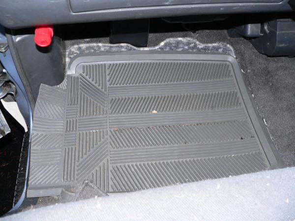

-has anyone gotten rubber floor mats? looking at the driver side it looks like i will need a special cut to fit around the steering column.

Front floor mat: Try the Michelin brand at Canadian tire (the rear one) they often come on sale for $10 each. They fit pretty good and just need a bit of trimming for the steering column.

And Delica shops should have a selection of mats sized right in stock; earlier this year I bought a nice set from CCAuto for cheap, cheap; had Glen had many to choose from.

Floor mats? I have kids. I found a floor mat that had a main area about the right size for the front foot wells and then another section that is meant to extend up the firewall. (OK well in a Deli we're sitting on the fire wall so I mean the wall that is in front of your toes... you know?) I trimmed off the extension part to fit the door opening and then put the mats in sideways with the trimmed bit sticking out towards the door so that if I spill something, there's a pretty good chance that a lot of it will drain side saddle into the step well instead of the carpet. I have since put my plan through extensive testing and for the most part, it seems to work. I'm actually rather pleased with this. So much so I've attached a picture. About cleaning your engine on the street; An excellent question. I don't know the answer to that but I certainly appreciate that the question occurred to you. Kudos!
