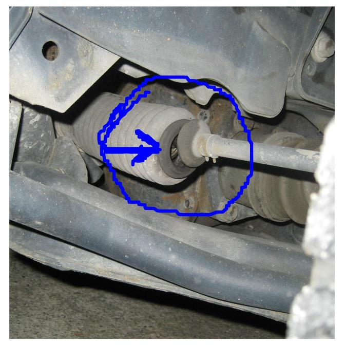

- Steering component ? I think it might be time for a new one none the less.

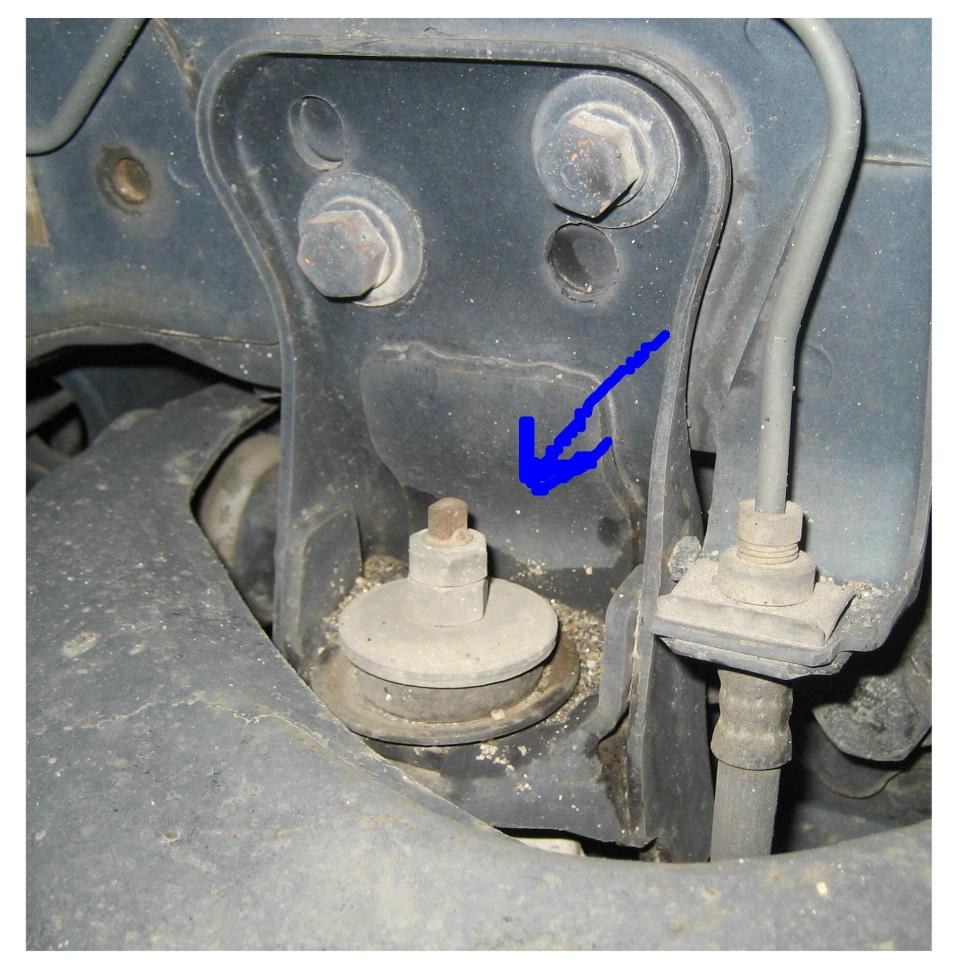

- upper ball joint ?

the second picture is the top of the ball joint...just under is the actual balljoint

The first picture is your steering rack bellows boot. If it's been torn for any length of time, you will probably need to replace the inner tie rod end that it protects as well. The second picture is the top of your front shock. Hope that helps!

My steering boot was torn as well. I taped it up with electricians tape. That was a year ago and the tape hasn't come off. The linkage underneath was clean otherwise I would've changed or cleaned the joint too.

The second picture is the upper shock mount, Note the double nut the big washer and the rubber damper.patty wrote:the second picture is the top of the ball joint...just under is the actual balljoint

my mistake.....got a couple pm's all ready, sorry
