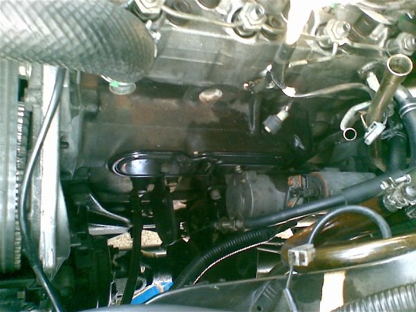

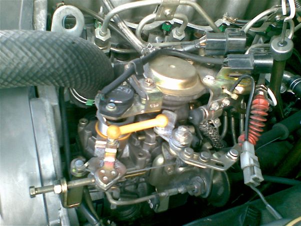

I opted for #4 and had the entire IP torn down, worn internal parts replaced, solenoid replaced, seals replaced and then bench tested (IP machine tested) for accuracy up to Mitsubishi specifications.
The end result is a very clean burning, smooth idle/speed, increase in power and better mileage.

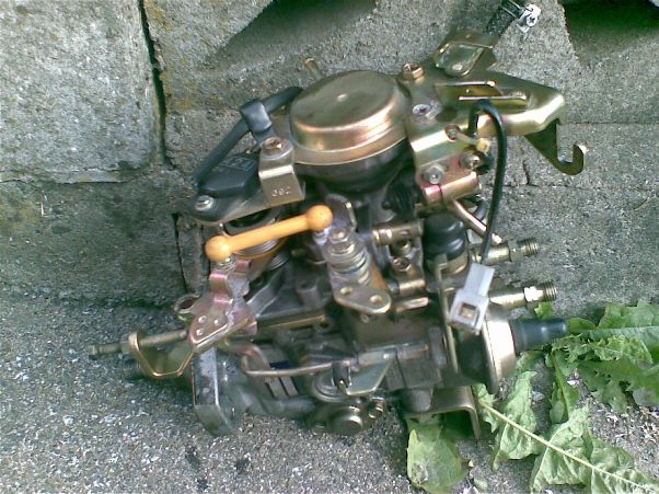

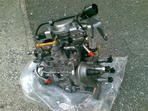

**NOTE** Not all Delica's have the same Injection pump's.
Some Exceed's differ from Super Exceed's and Chamonix models (different throttle linkage ... a/c thread length,etc...)
Original from Japan
Original from Japan
Out !
Out !
Old
Old
New
New

Mine was leaking (just a touch) and it was also blowing smoke pretty bad on acceleration/startup. Also shaking a lot on idle.
I had CVI clean the injectors, Delica-Tune, new filters, oil change, timing set, etc... but all of the above still persisted.
In come Mardy and the injection pump guys.
They said that just replacing the seals won't cure my problems.
Problems which I thought were normal on a diesel Delica.
After the IP rebuild, smoke disappeared, shaking at idle disappeared, power increased.
