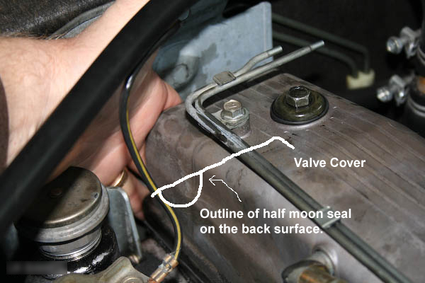

To get to my point, when I had looked on the forum in the past, I hadn't seen any photos of the location of the half moon seal, so I thought I would pass a photo on in the hopes that it helps someone else diagnose an oil leak from this location, as it really is simple to fix.
Feeling for half moon seal
So, in the photo (I have a large hand) I am reaching in behind the valve cover and I can just feel the half moon seal with the pad of my middle finger. If there is oil there, it's leaking. Of note in my replacement, the half moon seal fell back into the space when I tried to put the cover back on again. I found this out when starting the engine again and oil was practically gushing out of there... Had to open 'er up again and re-seat the seal. Just a reminder for the newbie to be careful and check and recheck it is in place correctly after replacing the cover.
Also, if you don't have anyone helping you, the two top bolts that hold the timing belt cover on need to be loosened in order to help get the valve cover off.

If you use a drop of instant gasket on smeared around the half moon it will hold in place so that the cover can be tightened back down. :wink:
The 2.8 engine has one at each end and they both leak!
