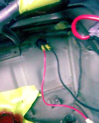

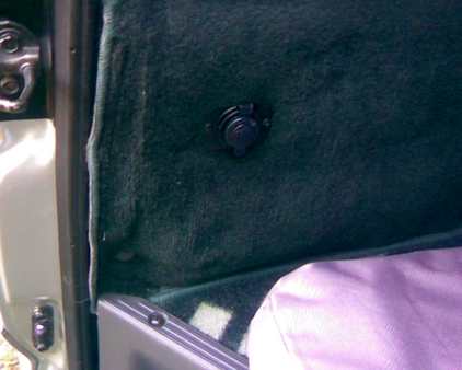

Garyo once told me that I was psycho for cleaning my valve cover. Having crawled under his ride I realised that he knew what he was talking about. So Talking with Jay & Christine of the TardisDeli I decided to go with a 12V plug that ran directly to the battery.
12V Plug From Front.jpg (12.73 KiB) Viewed 7379 times
It has thicker wires than your average cigarette lighter so it can sustain power longer without fear of catching fire, &c..

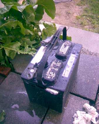

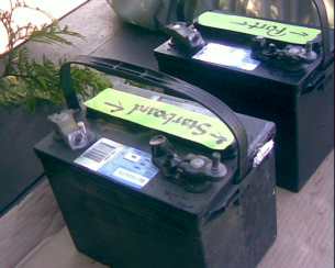

First thing was washing all the crap off the batteries.
Let's Clean All That Metal Eating Acid Off The Batery.jpg (21.42 KiB) Viewed 7380 times
And when comparing before with after:
Cleanliness is Next to the Engine.jpg (10.15 KiB) Viewed 7380 times

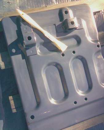

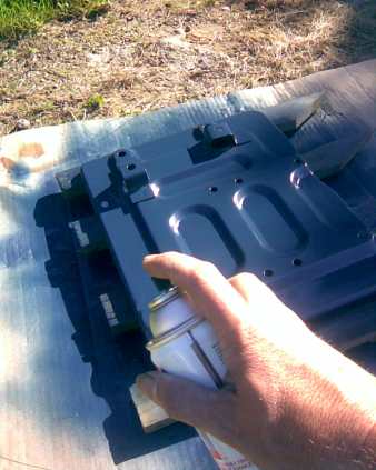

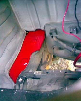

Unfortunately the acid had stripped paint off of the battery plate and the ledge below so I decided to clean them, too ~ and also paint them in order to protect them. However, it occurred to me that just plain old black was a little boring so I thought a little colour might cheer things up a little!
Just Black Is Boring.jpg (12.51 KiB) Viewed 7381 times
That's Better.jpg (19.83 KiB) Viewed 7379 times
There was some rust that I had to clean up and I used a little Tremclad to help protect the metal.

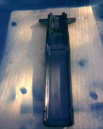

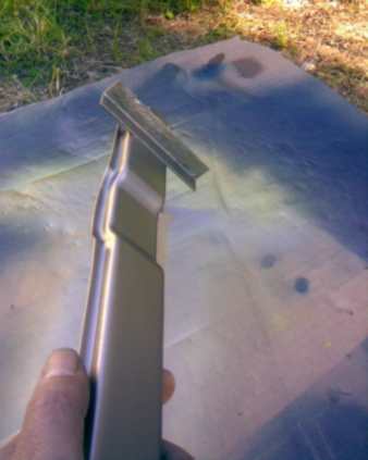

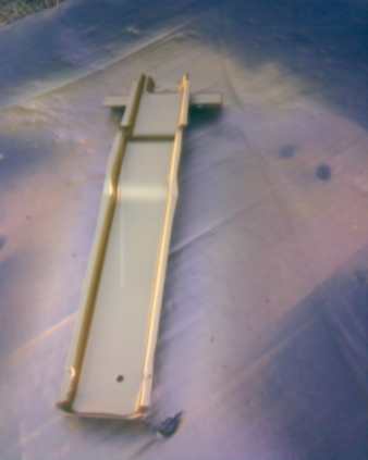

Next comes the battery brace and have I got an idea for you.....
Have I Got An Idea For You.jpg (11.36 KiB) Viewed 7349 times
Gold On Top.jpg (7.76 KiB) Viewed 7348 times
Silver Underneath.jpg (11.28 KiB) Viewed 7350 times

Jay has now got the 12V plug in place
12V Plug From Rear.jpg (14.3 KiB) Viewed 7345 times

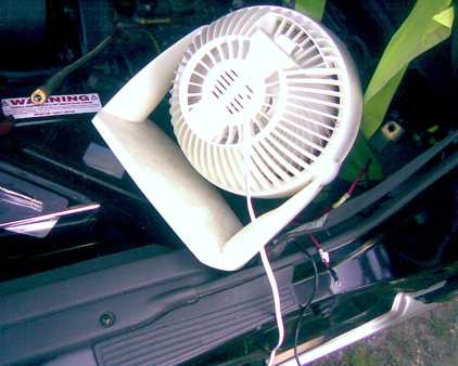

I guess it's time to start putting things back together and I see that the Tremclad is still a bit tacky perhaps we can speed this up a little
Cheating On Drying Time.jpg (19.5 KiB) Viewed 7348 times

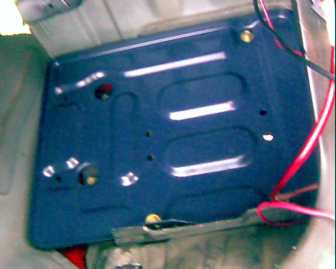

First comes the battery bank plate:
Bank Plate in place.jpg (9.75 KiB) Viewed 7326 times

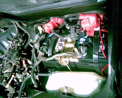

Nice, nice..... you gotta like that... :-D So when it goes all back together and:
Et Voila.jpg (25.33 KiB) Viewed 7327 times
Et voila! I have a new heavy duty cigarette plug; my battery bank is all topped up and ready for the next adventure; the metal surfaces are all protected; ~ and.... I have a really kinky paint job under my passenger's butt (and they don't even know it)! :twisted:
