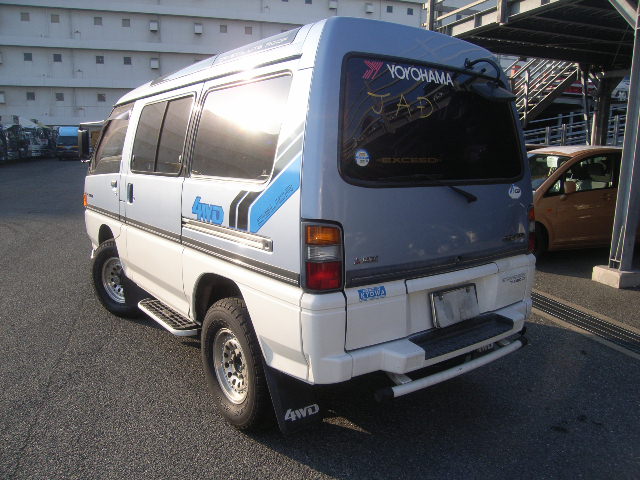

- There she is!
- delica.jpg (82.93 KiB) Viewed 3121 times

Now that your 'cat is out of the bag' as it were, the reality is most respected importers are putting a good number of hours in preventative maintenance once the 'good shape' is re-assessed here on this continent. Not to say all them are clunkers when they get here, but... they are 15yr-old vehicles.hammee39 wrote:It was a good deal at 440,000 Yen plus shipping and customs costs it works out to close tp $6000 Canadian. It has only 102,000kms on it and is in very good shape by the looks of it. When looking at craigslist and the buysell.com, it would seem that it would be quite easy to make a few thousand bucks by importing them and selling them here in Van. Do any of you already do this, and how has that gone?

Looks nice! And sliding window...
As mararmeisto pointed out these are 15+ yrs old and although they may run very nice you should still consider doing a full maintenance on it. The extra cost should be easy to justify as these are dirt cheap for what they are.
As for making money by importing, sounds easier than it is. You never really know what you'll be getting until you get it and the final price is now pretty close to one you could get locally. I'm not too sure if it will only cost you a total of $6000 landed, I'd say if you paid 440 000Yen your final bill will probably be closer to $8000... In any case, well done! You'll be very happy with your bus. And nice color by the way!
