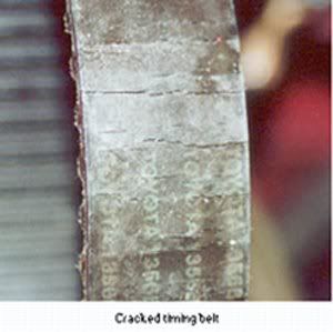

Now inspect the timing belt for cracks, look at the area of the belt that is stressed as you can see better, look at the edges to see if they are frayed ect... here is a severe case of an old dried up belt, your belt may look newer than this but may still have cracks.
There is also a smaller belt behind the timing cover, this is your balancer belt. Inspect it at the same time, for cracks or signs of fraying.
