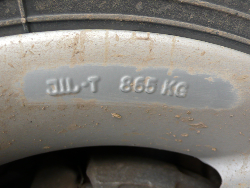

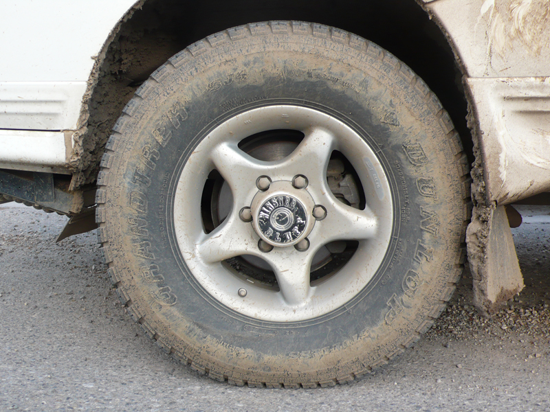

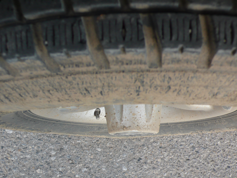

Here are some photos.
Hummm... I did not get what you meant by “pop a bead”...
