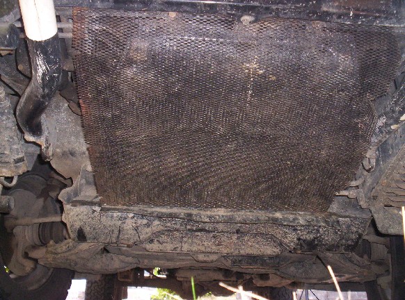

Using this template for dimensions,
Cut and bolt up expanded steel to fit the snow shovel, which I remove during the winter as it can pack with snow fast. Not pretty but sure can handle the price (free).

Not pretty?! It's beautiful! Simple, cheap, easy and effective. Good way to go, thanks.
