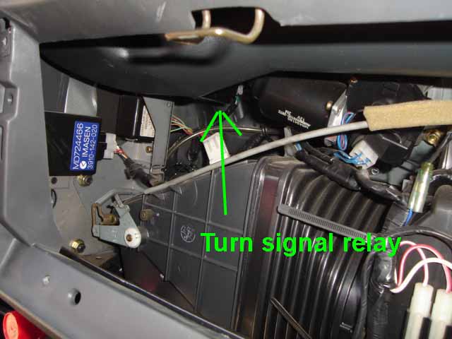

Since I took the photos, I'll post them. To get at the turn signal relay, remove the glove compartment. Then looking into the opening:

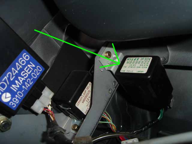

And a more close-up look:

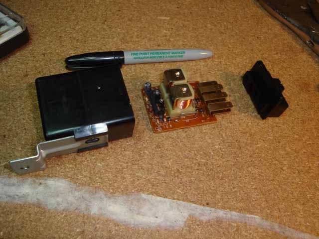

Edit: for the techies amongst us, here is what the relay looks like on the inside:
