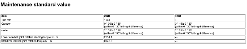

Is this what you are looking for?
I will have to do the same on my D5 when I change the suspension components and add new camber bolts.
Screen Shot 2022-07-30 at 10.36.36 PM.png (24.29 KiB) Viewed 6267 times

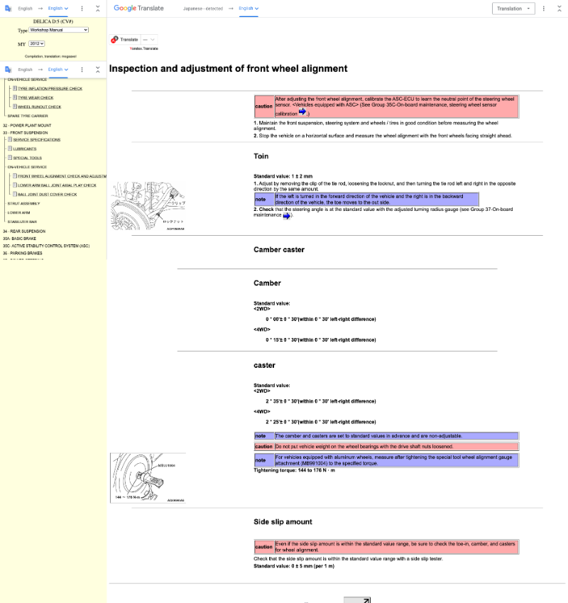

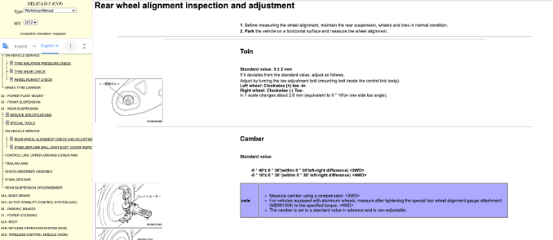

google translated service manual.
Front:
screencapture-mmc-manuals-ru-translate-goog-manuals-delica-d5-online-Service-Manual-2012-index-M1-htm-2022-07-30-22_46_31.png
screencapture-mmc-manuals-ru-translate-goog-manuals-delica-d5-online-Service-Manual-2012-index-M1-htm-2022-07-30-22_46_31.png (168.03 KiB) Viewed 6266 times
Rear:
Screen Shot 2022-07-30 at 10.48.43 PM.png (89.5 KiB) Viewed 6266 times
Hope this helps!

delica64 wrote: Sat Jul 30, 2022 9:47 pm google translated service manual.
Front:screencapture-mmc-manuals-ru-translate-goog-manuals-delica-d5-online-Service-Manual-2012-index-M1-htm-2022-07-30-22_46_31.png
Rear:
Hope this helps!
Where can I find THAT manual? would be nice to have a print out for when i take it to alignment. The manual on the Delcaclub.com site doesn't seem to get in to this type of nitty gritty.
