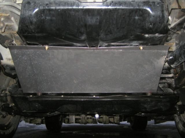

I'll concur with a Deli in the cold. A proper battery set-up helps as well.
in -10c mine would start but it always took 10+ attempts.
They key is letting it warm up properly and keeping it warm. I invested a few bucks on a piece of sheet metal and made what I call a "Winter Damn" that I mount down low in front of the engine compartment. It blocks the direct flow of air going into that area. So the engine stays a little warmer and it's not so drafty in the cab.
